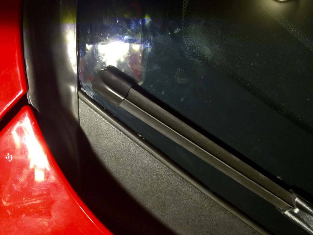

Confirmed.
My cowl was popping and snapping, sounded like I was riding behind a truck kicking up tiny rocks. The colder it got the more frequent the noises.
I installed Landshark's J-strip last night and today it was 20 degrees. Not a peep.
Looks totally OEM:
I paid $8.24 for 6.5' on ebay.(http://www.ebay.com/itm/272056947494?_trksid=p2057872.m2749.l2649&ssPageName=STRK%3AMEBIDX%3AIT)
Didn't have to remove the wiper arms. I only had to disconnect the pop pins and shift the cowls a bit.
It was a real tight fit stuffing the strip under the middle sections. But it seals nicely.
I noticed my '07 FX35 has a very similar strip in the same place. Needless to say it never had the popping noise.
