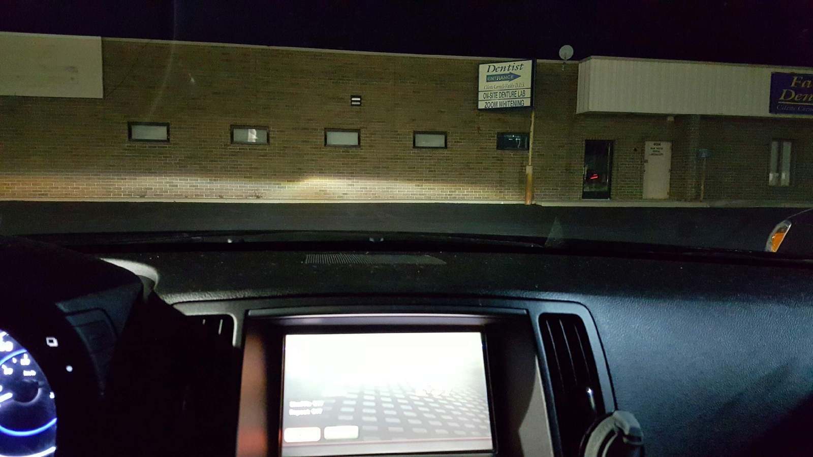

When they were originally installed, the "hot spots," if you will, were dead center and cutoff was pretty damn good. However, I have noticed recently that my hot spots have shifted to the left of the car. I can't think of any foolish event or impact that may have happened since the install to cause this, but I'm otherwise stumped. I'd like to know if there is a relatively simple way to correct/shift/rig the bulbs to face more center?
I've had the bulbs swapped across as instructed, and that actually led to some weird effects. I recently swapped back in the OEM bulbs, thinking it was a bulb issue, however the issue still remains.
I've included some pictures for reference, I apologize if theyre not the best. Any insight or guidance is more than appreciated, guys.
*Please pay no mind to my pictures being first and
Passenger light is right center of vehicle
Driver side has actually shifted more left than shown now.

also note that the stock projector and lens isn't the best in the market so you'll never really achieve those sharp cutoffs with a nice even light pattern unless the projector is modified to include a cleaner and sharper cutoff shield and more importantly, a clear lens. I'm shipping out my headlights to 180 for this exact fix to optimize my projector/cutoff shield as well as a TSX-R clear lens. I have own both the CBI and Nightbreakers from Osram, the nightbreakers are an awesome awesome bulb if you dont care too much about aesthetics.

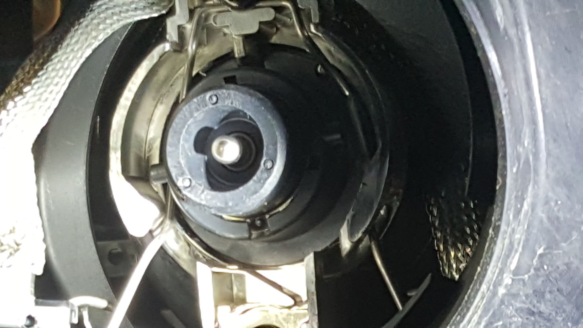

So I took it to belle tire......this is what we found.
Looks like the clip is broken on the left side of the device. Same thing on both sides. Any idea if this part can be replaced individually?

Ah the stupid clip turns out to be the culprit. I'm sure Infiniti will sell you just about any part.
First, do you think you could take it back to the original shop? Ask them if they can do anything about it. I'm wondering if they did it in the first place...maybe they can make it right.
One caveat: if they muffed it the first time...they might make it worse without the proper supervision. You now have the knowledge and the insight to speak to them with confidence. Get 'em to have a look and tell you what they think.

That clip is broken on one of my lights too, found that out when replacing a burnt out bulb so who know how long it was like that. I just bent the spring steel part around the back a bit and it holds in place no issues.

Well, went to the shop with information in hand. They were VERY resistant to believe what I was saying to begin with, however when I showed the owner the write-up from the other shop and started talking liability, the owner was very apologetic and is pushing through an authorization to get both headlight housings replaced, with labor, at the dealership. This is like a $2600 repair.
