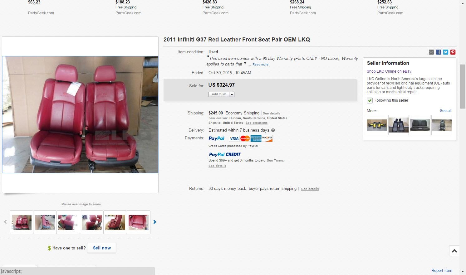

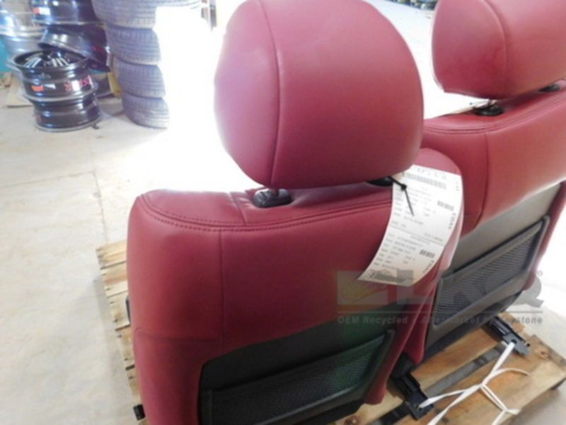

Hey Guys just bought these for a Great Deal on ebay.. couldnt pass it up, Im just curios I have an 08 i should be able to fit these even if there from a 2011 model, also these look a little burgundy and not red, are there 2 versions of the OEM red seats, for IPL and anniversary looking for the rears now and just dont want to have any issues matching the colors up. Thanks

Im not sure, There being sent to my body shop, my first time swapping out seats so I pretty much have the same questions. hoping all goes well with instal

OP, I did the swap from non-sport to sport seats in my coupe and IT IS PLUG AND PLAY AND BOLT ON WITHOUT MODIFICATION. The only issue I ran into was with the driver's seat. My donor sport seats were from a manual transmission, while my car is automatic. The control boxes on the seat are specific to the transmission. They are rectangular boxes on the bottom of the seat and are marked with either "AT" for auto or "MT" for manual. Worst case scenario is you have to swap in your stock control box, which is what I had to do. The passenger seat should be marked as "AS". Refer to the pictures for reference.
Thanks this is real good to know, i have MT and im almost positive these came out an auto.

If you have the wrong box, everything should work, except memory seats. When you swap for the correct box, memory seats will work.
