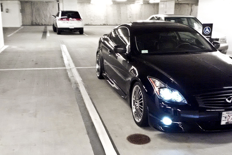

Sean you follow fine . I have 3 sets still have them at home( Some place). I couldn't get any of the 6 bulbs to work on the passenger side and gave up and just put the stockers back in, An yes I ran my 2011 Coupe with their 8K HID's, fogs and DRLS for the whole time I had it 3 years. Turned it in with them in it also. "Pic below"
The D2S:Morimoto XB HID I just got are 6500k., 56$ shipped
