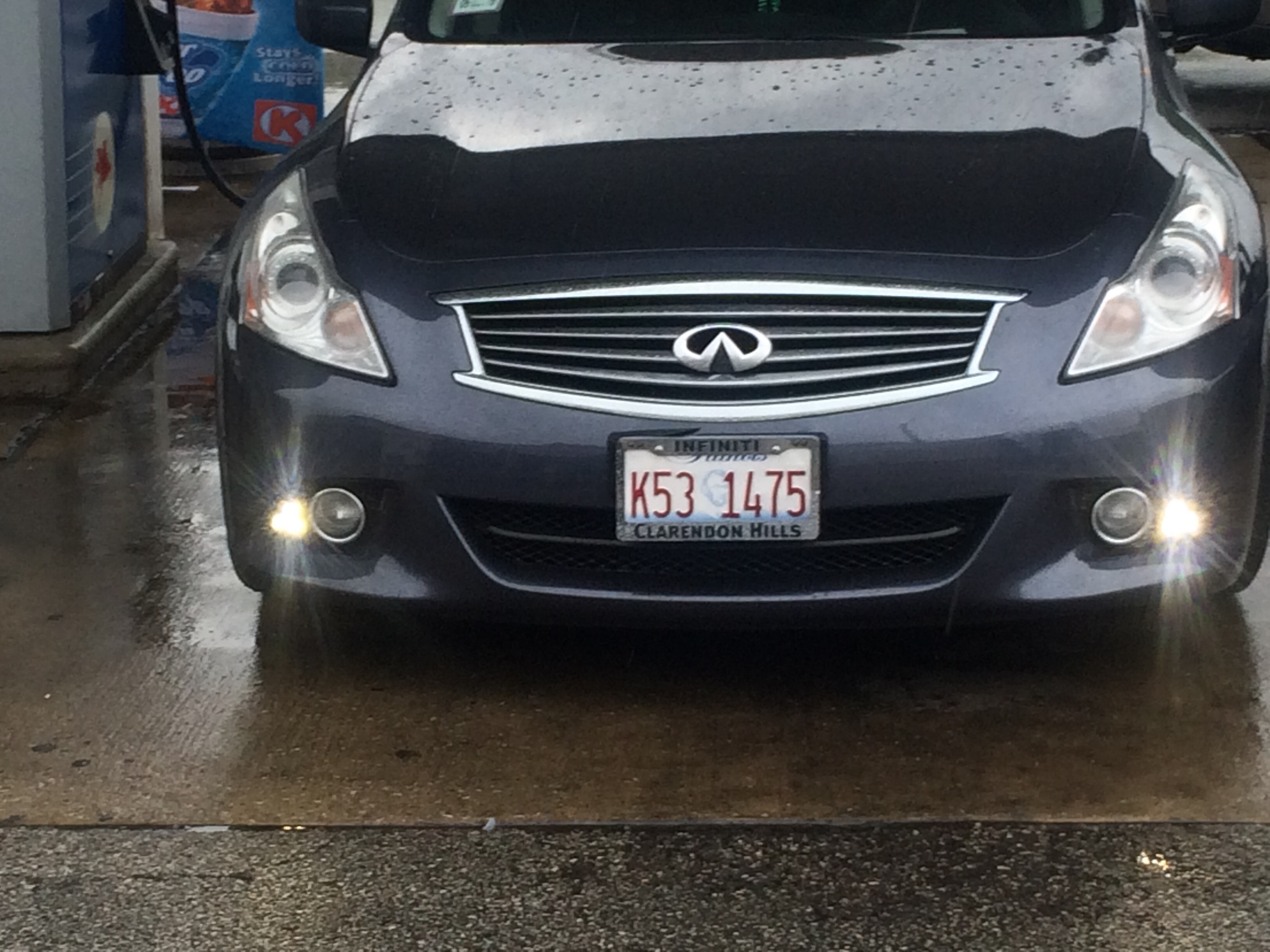

And installed...

OEM DRL LEDs
Looks good! Glad the install guides helped out.

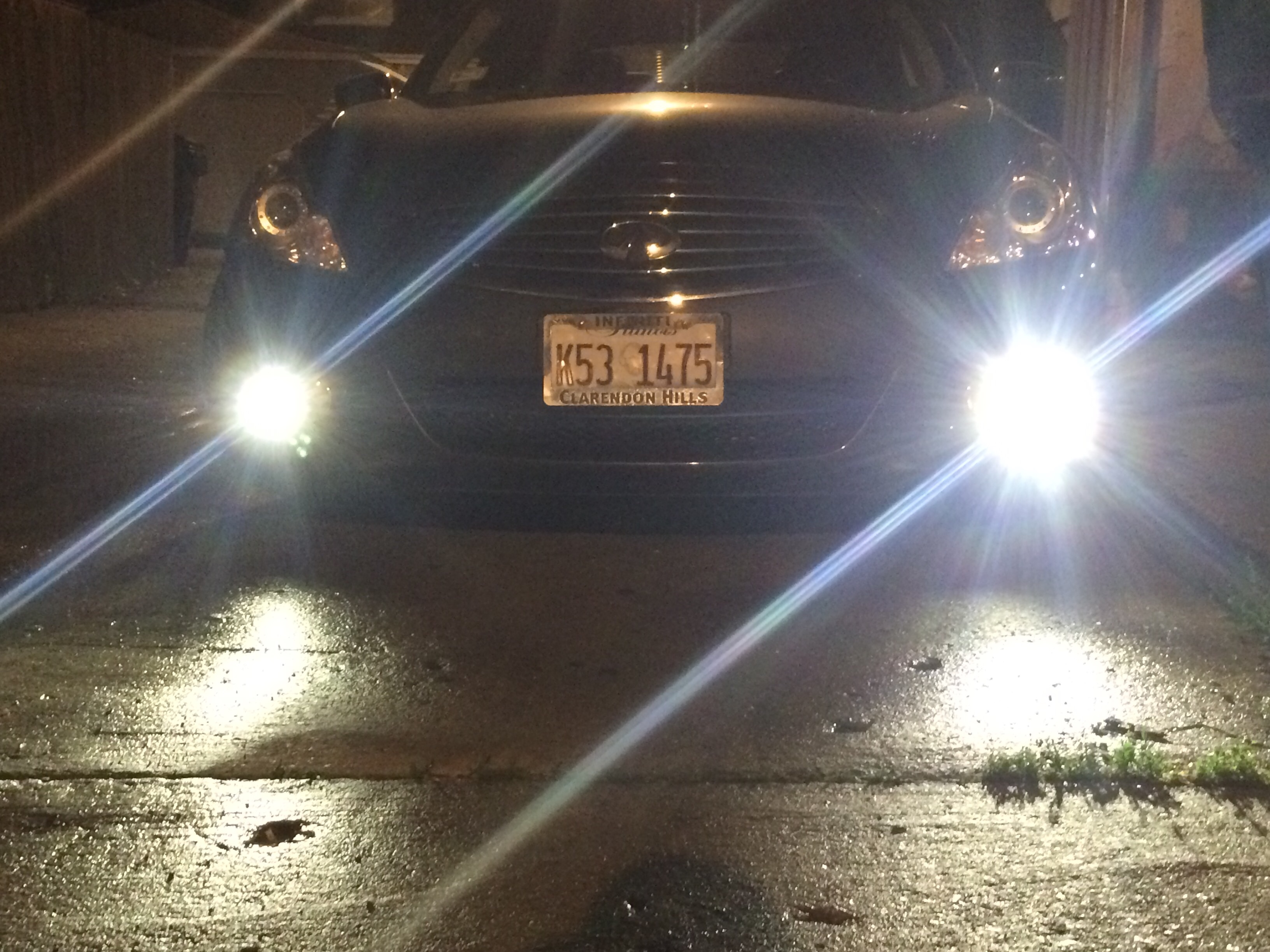

Yea the guide was perfect, very detailed. The only issue with it is the fact that they mapped out the wrong pin hole on the ipdm cable. The spot they say to use is actually already filled with a cable. I plugged the accessory power cable onto the opposite side and it still worked no issues. There is only two open spots on that part of the connector and I believe both will work as there both positive leads. Here's a morning shot.
