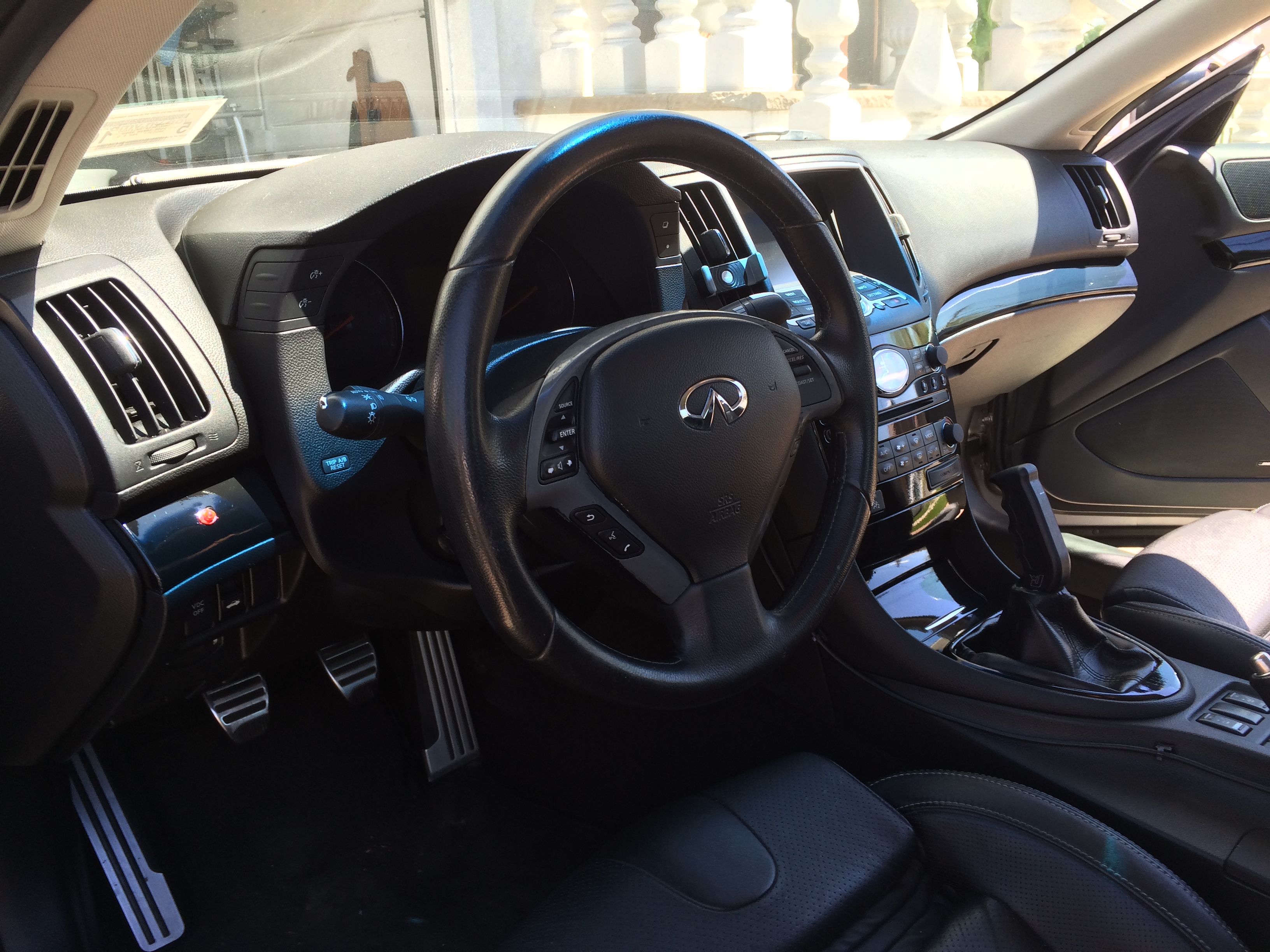

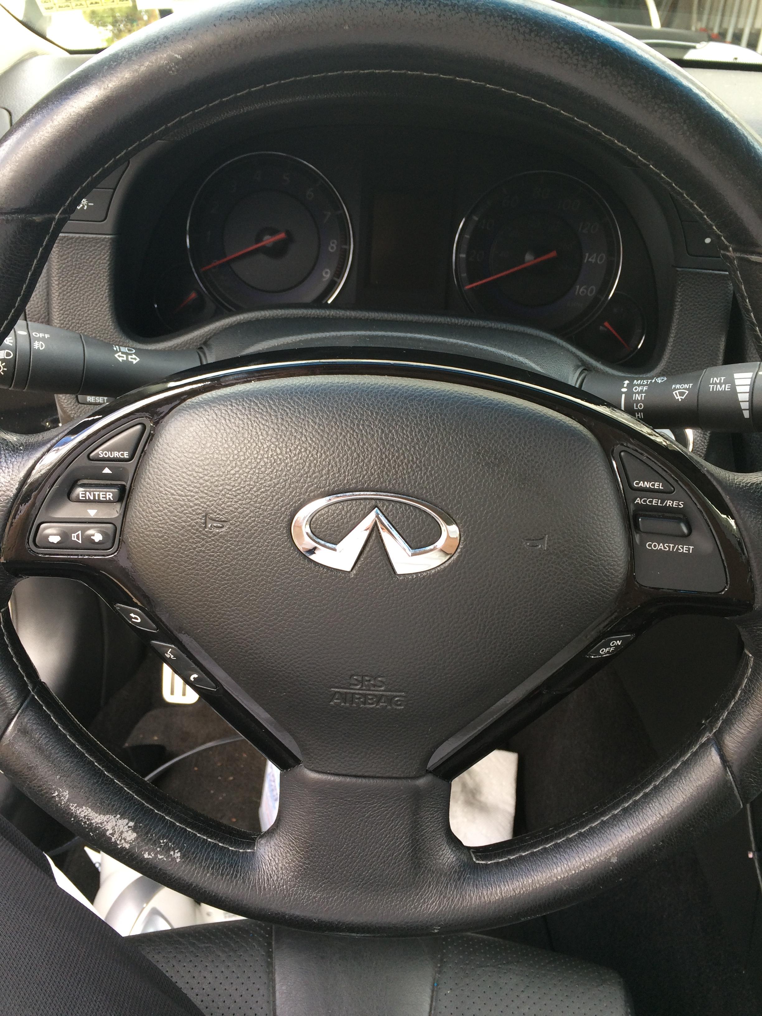

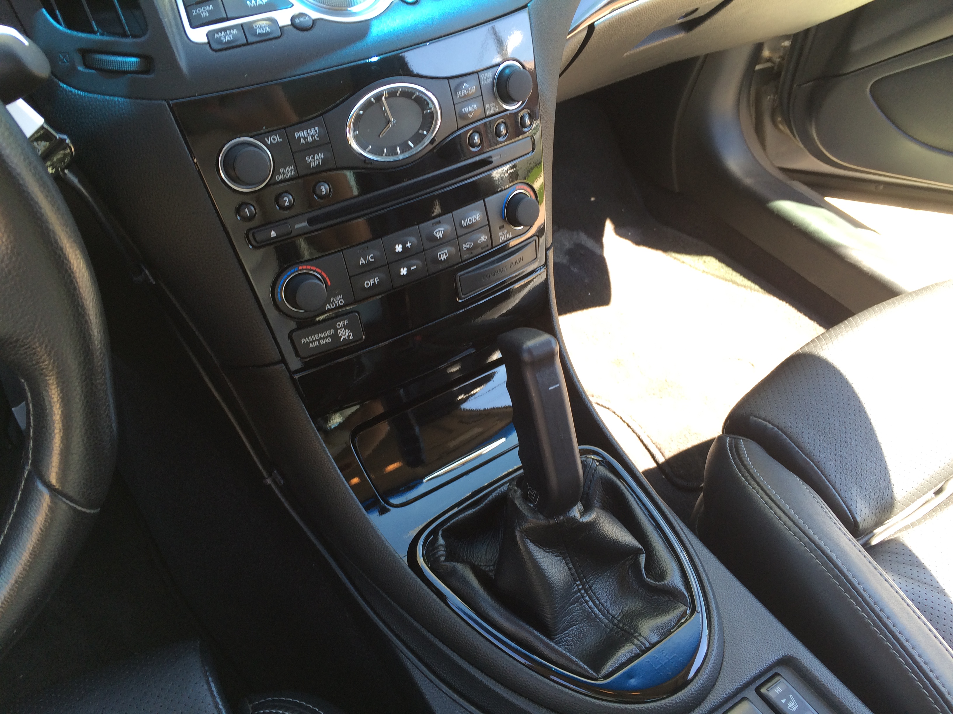

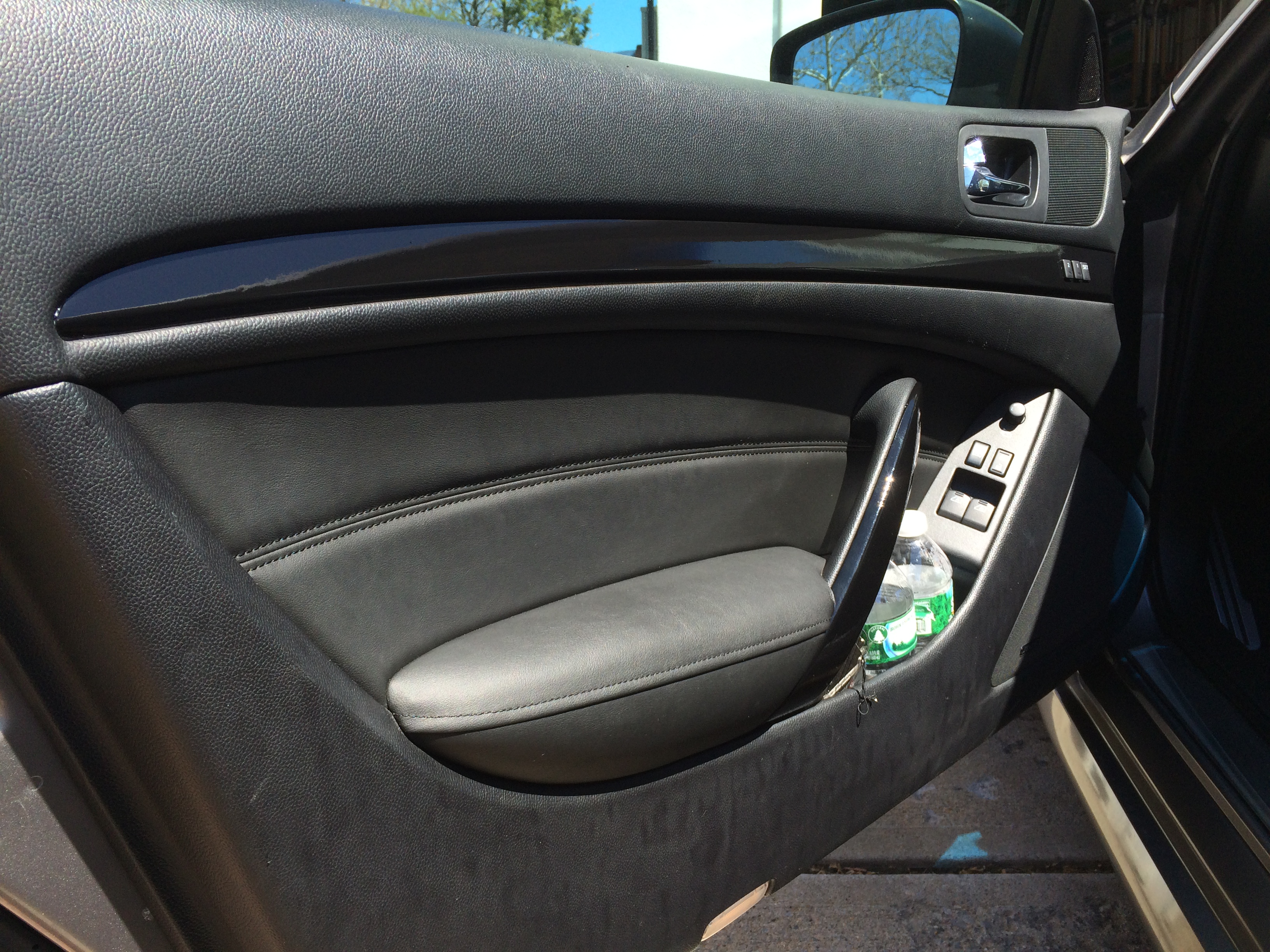

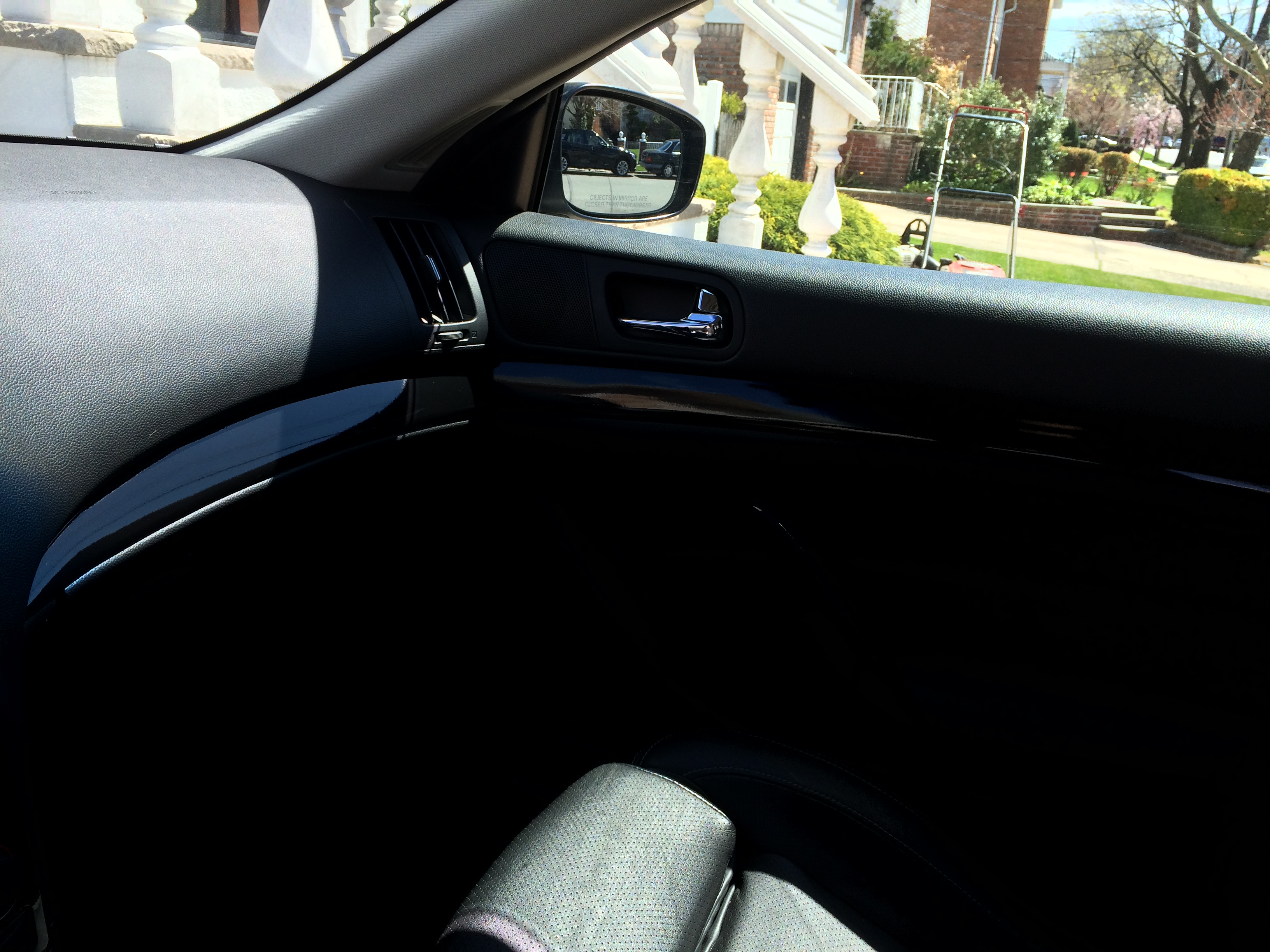

Well, I got my vinyl and wrapped everything up. It was seriously easy. Hardest part was getting all of the trim off the car. Took about 4 hours total. My first time with vinyl on oddly shaped surfaces. I love the new look. Thanks for all your help guys.
I even did my steering wheel trim because it was seriously messed up. Just took the horn pad off and did it while it was on the car.
Ignore my dirty door panel...

And it wasn't too hard. I pulled the whole bottom section out, then removed the ashtray part where the door is and wrapped it. I wrapped over the chrome and made sure to really form it tight around the chrome piece, then cut it with a razor blade.
The center console was 100x harder

You just take off the front? NOthing holds it in like screws?
Old May 8, 2015 | 07:16 PM
  #26
Thirty_Seven's Avatar
Thirty_Seven
Joined: Jul 2014
Posts: 629
Likes: 69
Horn pad has 2 torx screws holding it in on the side. There's a steering wheel removal DIY somewhere around here that includes it.

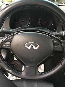

Here is mine, mostly 3m 1080 vinyl. Climate and radio controls are 3M brushed black metallic, door handle cover is covered with 3M brushed titanium, and the door trim , shifter base and dash trim I used VVivid8 gloss tech art carbon fiber. For now I like it, it flows very well with the assortment I used

Me too, at least from the pics you posted it looks like it actually works pretty well. Not sure how all the different textures would co-exist but maybe
BTW, how does the VVivid8 wrap compare to the 3m 1080 in adhesion, stretch, consistency, and quality? I like the fact that the carbon is glossed, looks much more realistic than the flat 3m carbon wrap that I've used.

I live in phoenix and its held up to the 115 degree heat for the last 2 years. Adhesion is good; you are definitely going to need a heat gun to make it 10x easier to work with stretching especially around the corners.
The Vinyl seems to have 2 layers, top being a tinted clear and under part being the carbon fiber graphic. I would say 3M is a lot easier to work with, and more forgiving. Other than that I have no complaints whatsoever. I believe this product is close as you’re going to get to the traditional carbon fiber look at this time, one of the reasons I choose it.
