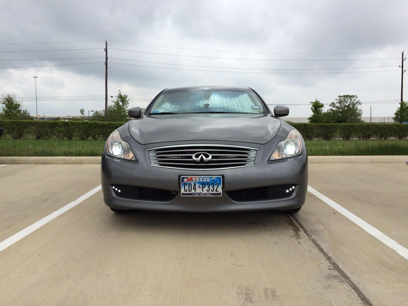

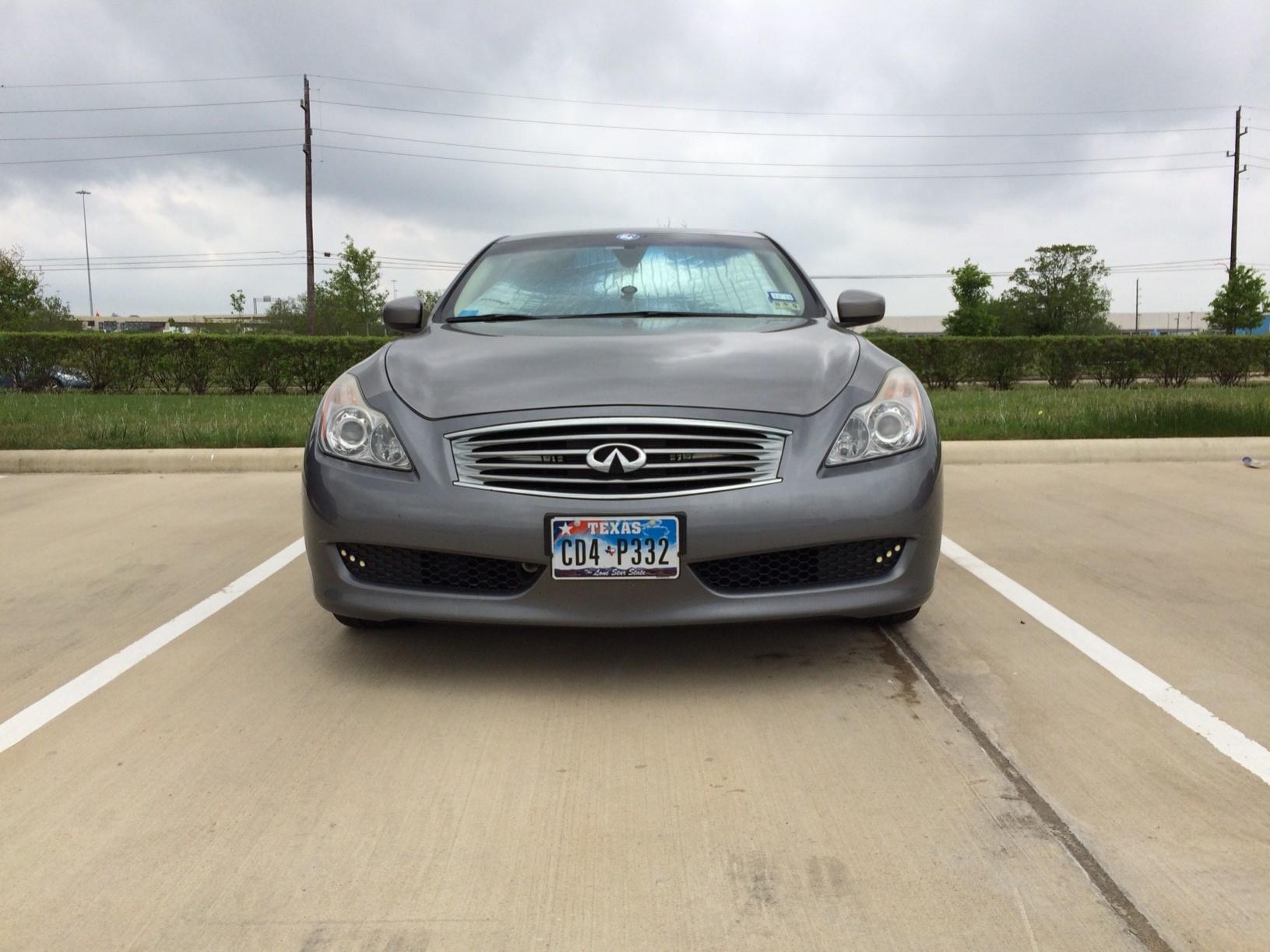

Excellent work! Very clean! I did something similar to my 09 Journey... 3 per side, diagonal... will post pics soon. cheers.
Felipe.
Old Apr 3, 2015 | 12:39 PM
  #80
FelipeRueda's Avatar
FelipeRueda
Joined: Sep 2013
Posts: 39
From: Katy, TX
Mine! Don't show much on the pics but are bright enough during day without being disturbing to upcoming traffic at night!
Interesting design..
Can you tell us what you used other than the LEDs (eagle Eyes Im assuming?)
Try to post more pics!
