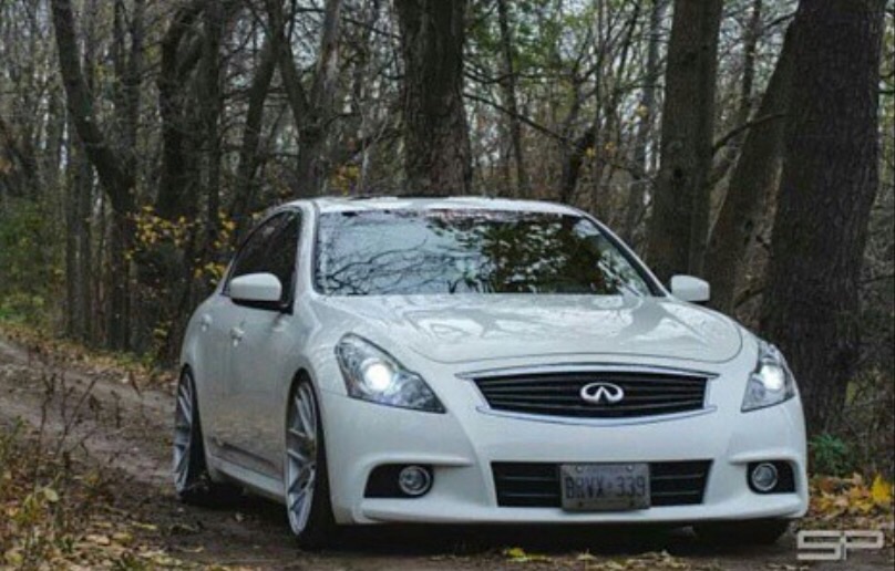

So I've contimplated the idea a few times to remove the Amber parking lights when the headlights are on since I hate the look of the headlight housing with the HID headlights and the ugly Amber next to it. I always pictured it would look much cleaner with only the HID headlight on, but I've never seen this on a sedan until today, and I was absolutely correct - SO damn clean!
How can this be accomplished? The blinker would obv still need to be functional when that turns on but I just don't want it to remain on as a parking light. Any one attempted this? Any DIYs out there??

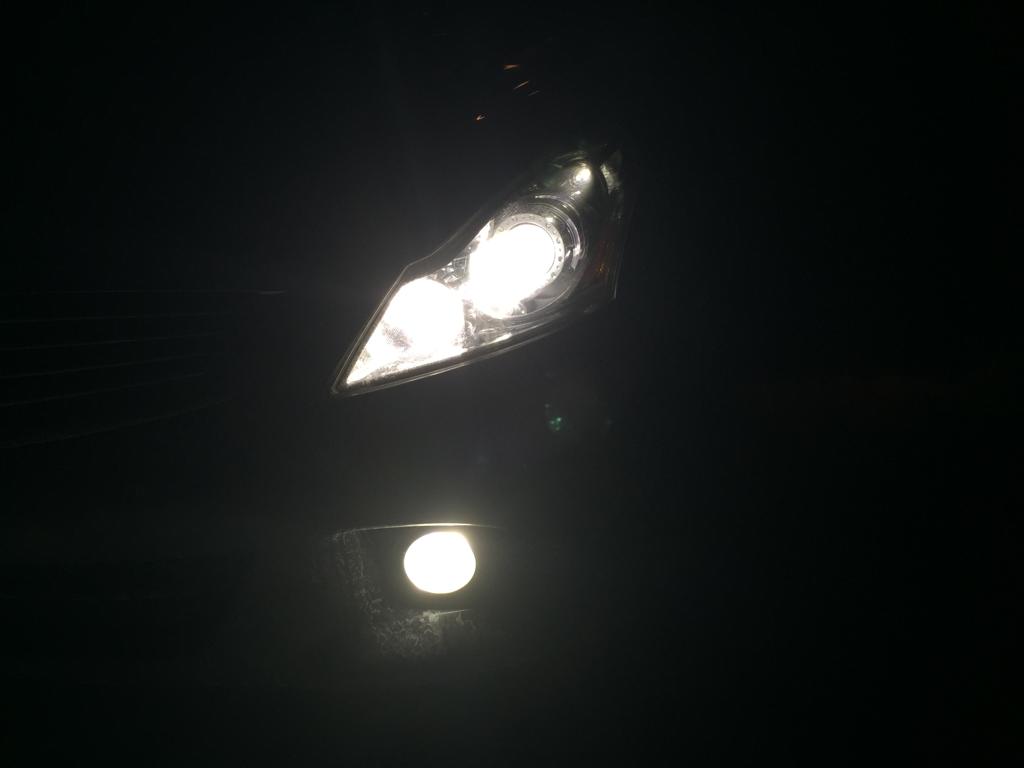

I'm well aware of the switchbacks but I don't want any illumination of that bulb at all when the headlights are on, only the headlights. I feel like most white LEDs will not match the HIDs, and some of them are too bright and they "drown out" the HID light because they are powerful LEDs in a halogen light housing.
The projector headlight on its own is the look I want

Wow just saw this. That's my car lol. It actually happened by accident. Bought switchbacks. Dropped one and it stopped working.
Basically what I did was tape off the connection point on the bulb that powers the parking light. It takes trial abs error but won't take more than a few mins once you have the fender liner Out.
Pm me for any questions
