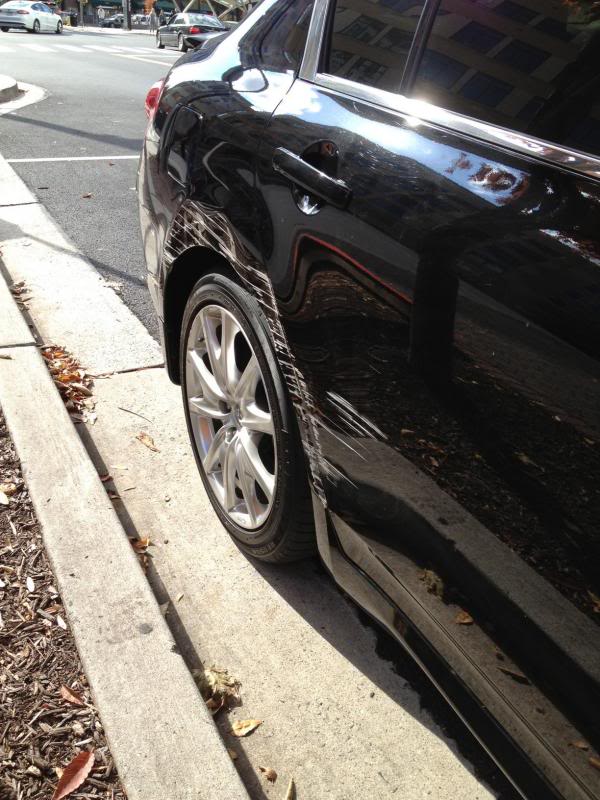

Not at all proud to admit I did this little number to my car, approx 6 months from rolling off the lot
BUT I am proud that I shopped around and found a great body shop that I continue to use of paint work (mods)
They reconstructed the wheel well perfectly and blended the rear bumper, rear door, and rear quarter panel to a shade indistinguishable from the original finish.
(Not bragging just saying OB paint is certainly matchable)
Mine was on the same exact spot!
https://drive.google.com/file/d/0Bwf...ew?usp=sharing
Yea i know it shouldn't be as difficult as it's been. I just wonder if i should have another shop possibly mix the paint and have the current guy do the labor. Or let him keep trying to get the mix down.. I just don't know the best route to take.
