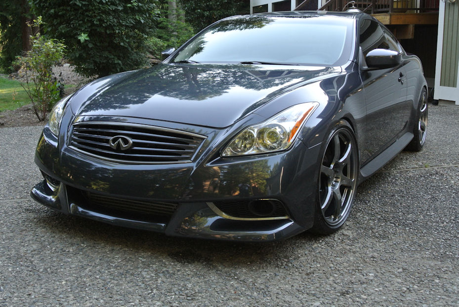

hey guys i got a 2008 g with the ipl front bumper with the fog light holes but no fog lights in them because the air filters for my turbos are there but i have seen a lot of G's with the 3 led next to the fog light where can i buy them and do they make it for the ipl bumper?

Not sure if they'll directly fit your bumper cover or not, but the OEM DRL's you speak of have 2 part numbers, depends on transmission type:
b66m0-1nh00 manual
b66m0-1nh01 automatic
Link to the install guide for reference. See page 19 for the size & location of holes that need to be drilled, should be able to determine fitment.
https://www.infiniti-techinfo.com/as...1/T/K/1TK3.PDF
