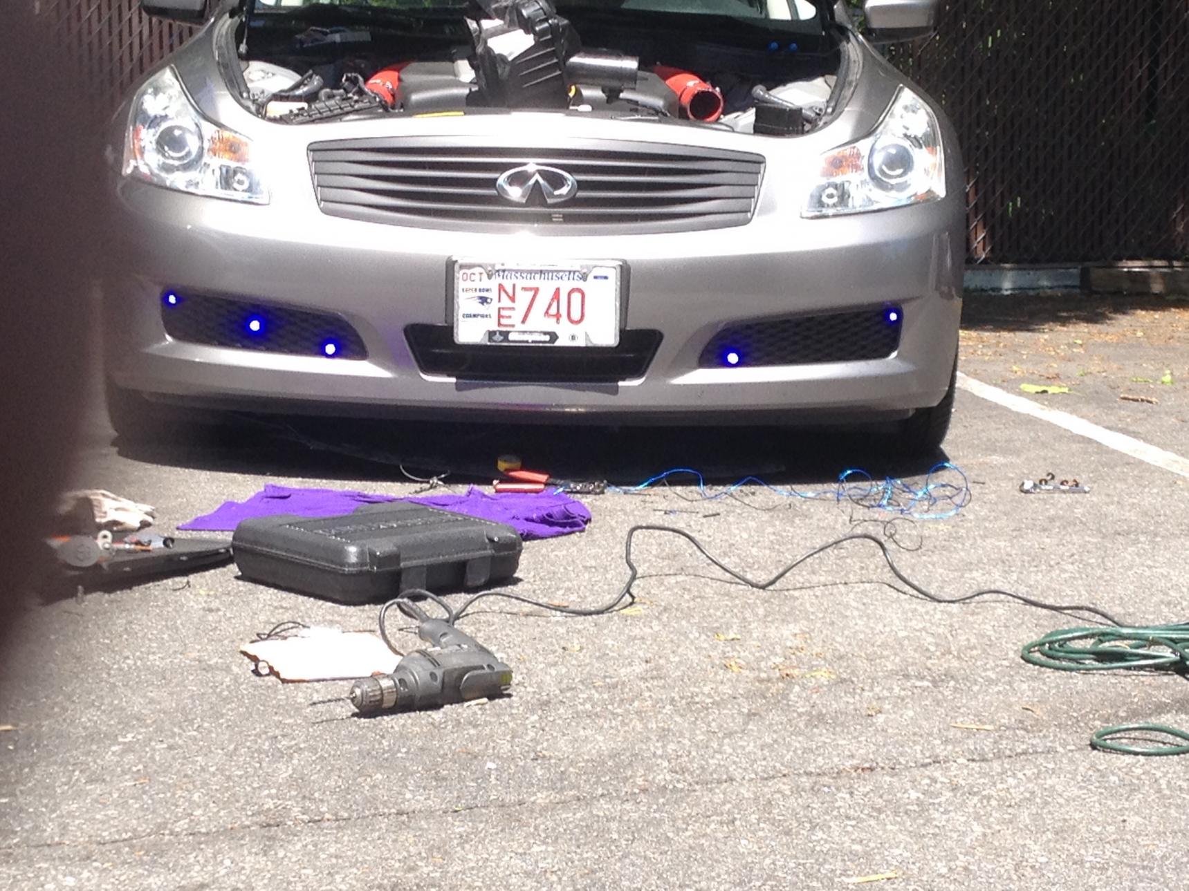

So I bought these off eBay before I went in vacation last two weeks ago and installed them today. I wired one of them to the marker lights fuse in the IPMD box and grounded from the battery , an wired the rest to each other (parallel) one of them was damaged durning install- wires came of so I have to order one more . Wife came up with the slant idea and I will get some more tonight but here's a teaser lol

Hey guys , Yea blue ! I really like them a little bluer than I thought but still cool .

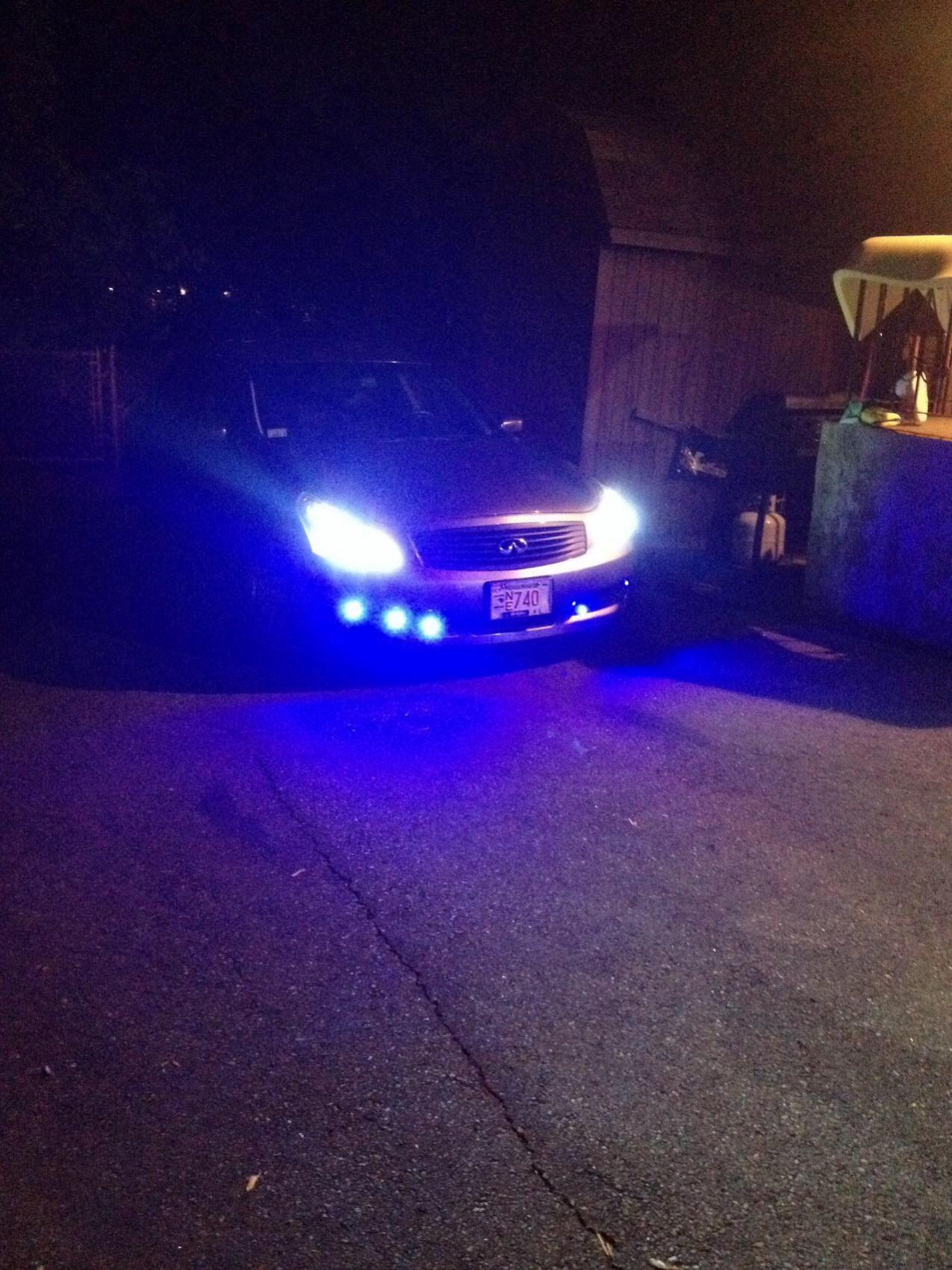

Here is a night shot of them I'll post more tomorrow . The wiring was pretty strait forward if you've done something similar before .
All is did was use the battery's ground , I used the fuse for the front parking lights for power,I had a plastic wire loom from my old stereo install kit , ran both wires in it down the passanger fender following that main wiring loom down behind the washer resivour, wired the driver side lights together wired then to the power and ground and then tapped the passenger side lights into the main power and ground wires . Tie wrapped up everything under the radiation an behind the bumper ! Was a pretty long job but not hard I spent 4 hrs on it but I really take my time on things thinking and picturing things before I do them. Like a mock set up then I run it that way ,

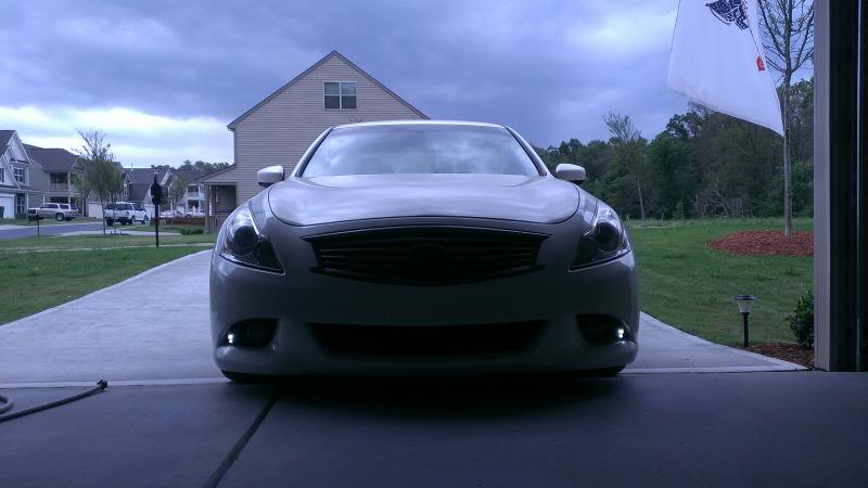

Kudos for wanting to be different.. in my opinion I prefer the LED's to be really close together. But hey its your car.

I believe it was your install thread that inspired ANMVQ and I to order those eagle eye led's, lol. Thanks! I like how they turned out for you. I went with the white one's and bought 8.
I have a '11 coupe with the lower fogs and that faux chrome surround and line-- so I'm not sure if I should vinyl over the chrome bits and black them out first.. I'd like to mimic the placement you did with you sedan, tight grouping/line, and tucked up into the upper outer corner of the bumper port holes. Probably would try to do three, but that plastic chrome really takes up some space. Def a June weekend proj.
