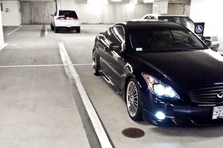

I did my city lights, HIDs and fogs all 8k

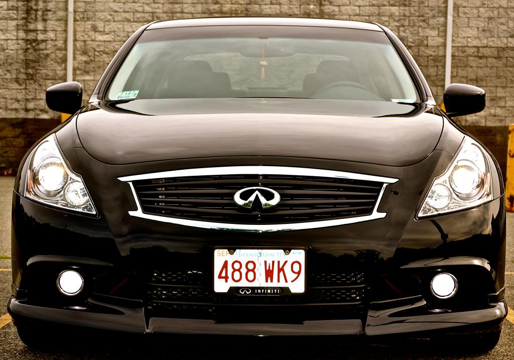

Thumbs up My Set Up...
Fogs: 4300K H8 HID Conversion kit
Headlights: Osram Xenarc 66240 CBI 5000K HID Bulbs
http://www.theretrofitsource.com/com...l#.U0dwnl64S7c
DRL/Turn signals: V-LEDs 6000K 7443 LED Switchback bulbs w/load equalizer resistors...to prevent hyperflash.
(no longer available for sale)
LED LOAD EQUALIZER RESISTORS PARKING LIGHT BULB OUT WARNING FIX | 1 PAIR
Parking Lights: 5000K 194 LED
http://www.vleds.com/catalogsearch/r...=194_4_RB_W_5K
Gabe...already knows my set up
