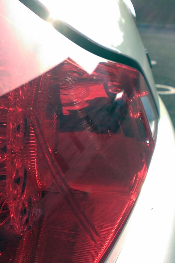

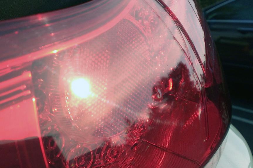

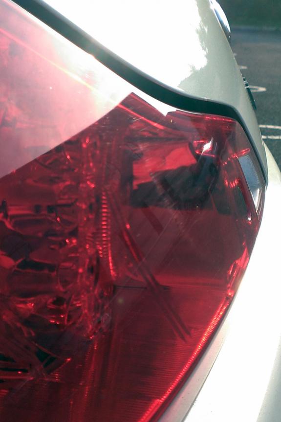

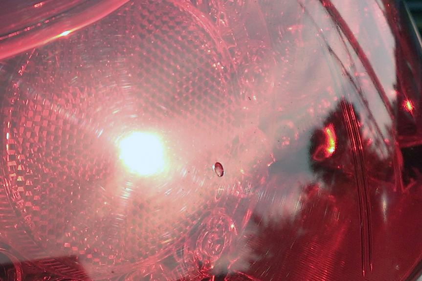

Any suggestion on what to use? Plastix can be a mixed bag and cause swirls itself. I heard good things about Mother's Plastic Polish. Also, there's a long, fine scratch on one that yo can catch with your fingernail. As promised, here are the pics ...

That's not too bad, the swirls look fairly shallow but the long fine scratch is somewhat deep. Regardless, all of those can be removed safely. However, it is somewhat hard to do by hand. Your hand power is no match for a buffer going at 4800 oscillations per minute.
I would try Meguiar's ultimate polish and a foam pad first. I think they have kits at auto stores, hard to remember exactly what they are since 90% of my products come from online. However, you do NOT need a plastic specific polish. Meguiar's Ultimate polish is probably one of the least abrasive ones you can buy over the counter, so I would start with that. If you want to speed it up, use Ultimate compound first and finish with ultimate polish.
I would recommend this kit if you want to maintain your own car. I can't speak on the quality of the polisher(I have 4 different ones, use Rupes 21 and Griot's garage polishers the most), but the actual polish itself is very nice and the pads should be pretty nice. This is the cheapest one you can buy, also one of the safest. 110% better than anything by hand. Those swirls on your lights will eventually re-appear, and this will easily knock them down in 5 minutes: http://www.3dproducts.com/HD-Polisher-Kit.html
