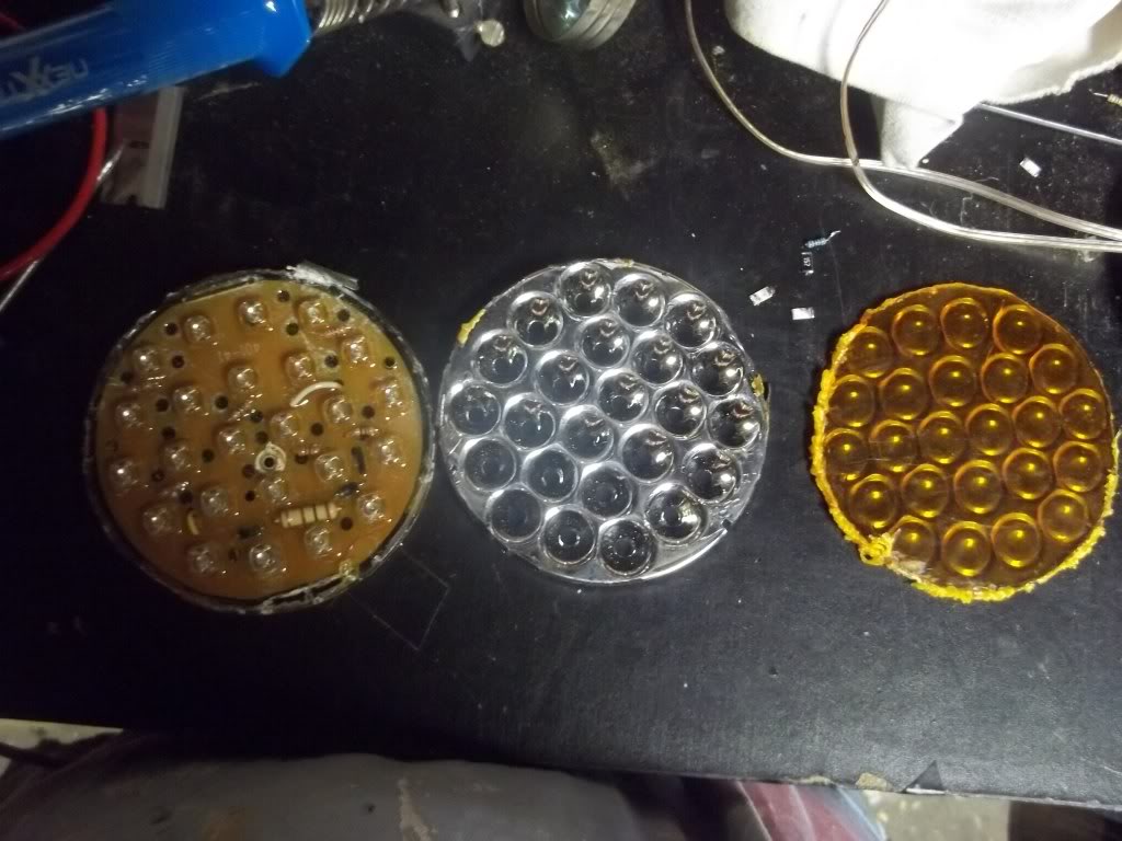

I've worked with similar setups and changing the LED's isn't really viable on those setups. They're actually sealed super tight with a fairly thick coating once the circuitry is done, and as such, are next to impossible to tamper with. If it was just a blank circuit board it'd be a cake walk.
To top that off, Amber/Orange LED's are pretty near impossible to find. You can find Yellow simple enough, but good Amber/Orange is tough.
The LED Circuitboard/Reflector that you have there Newt, are actually all the same, they use the same one for all of the LED fog lamps they make, just different housings/mounts. "Spyder" is the manufacture of these housings.
If you can find out what size that Circuit board is, you could purchase one in whatever colour you want and swap them out. Not a super simple job, but certainly possible. At the least, it's always nice to know that option is there.
If you can, rough-measure the Reflector Diameter, I'd wager to say it's around 4", the standard for these types of LED lights. If this is true, then the options are decent for styles and colours, because the Heavy-Haul Trucking industry has these in surplus.
Here's a 4" circuit board and reflector I took from a Tractor--Trailer 4" signal lamp and put in my maxima signal light, then installed a cut-to size Lens over it:
Doing it would reduce light actually put on the roadway, but really, that's not what this is about, is it? If you wanted lighting put on the road you'd spend the money and get Projector Fog lights. This is a cosmetic/DRL thing, and I love that, because if the mounting isn't perfect you're not going to blind oncoming traffic
