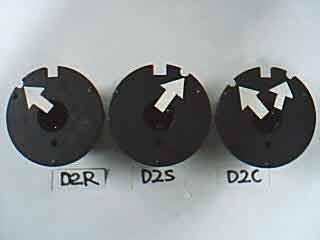

I paid 10 dollars for my 6000k bulbs on ebay and I haven't had any issues with them for the 7mths they've been on my car. No problems firing up on startup. Not sure why you guys are having issues. I had this same issue with my Maxima. Could be faulty ballast but i really doubt that especially since the factory bulbs work fine. All i can think of is to make sure you guys are getting D2S bulbs and not D2C. D2C bulbs work universally for both D2S and D2R. Maybe the d2c doesnt have a good enough connection like a regular d2s bulb will have. Ill post pics to show the difference.
