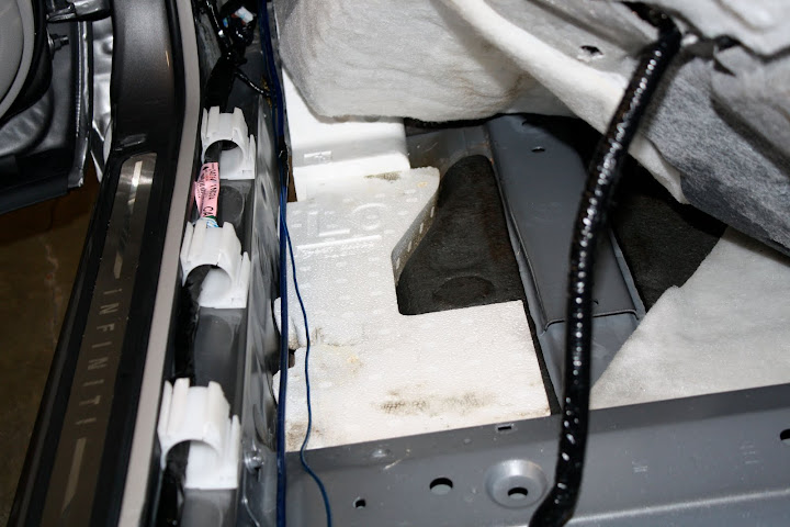

I have pics and can show exactly what happens with the non-sealed main bus grommet.
here is the culprit grommet.

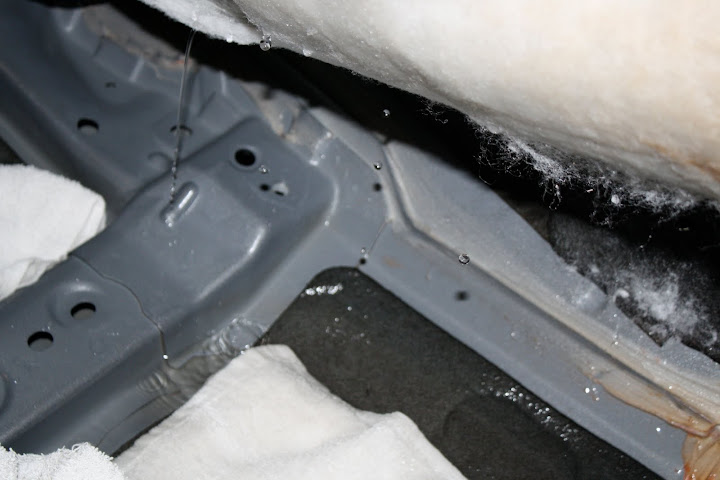

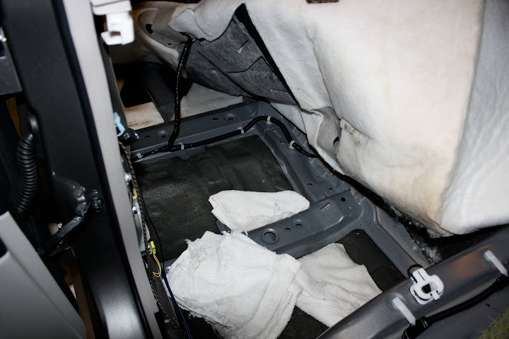

And here is what happens:

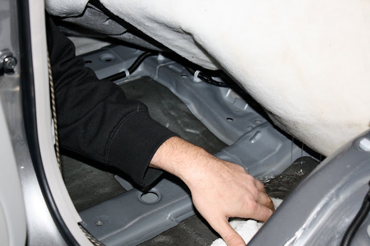

See how deep those wells are?
Many towels later

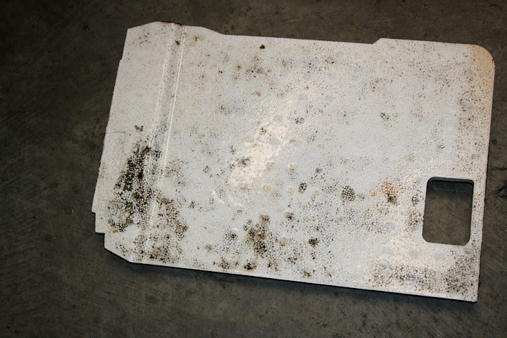

Mold on styrofoam inserts....
Had the carpet and the inserts replaced, and the whole dang thing cleaned with bleach. Had to take out entire interior, then carpet. Then deal with the insurance company, the nody shop that kept effing up parts, etc. Was a g0d@mned nightmare.
