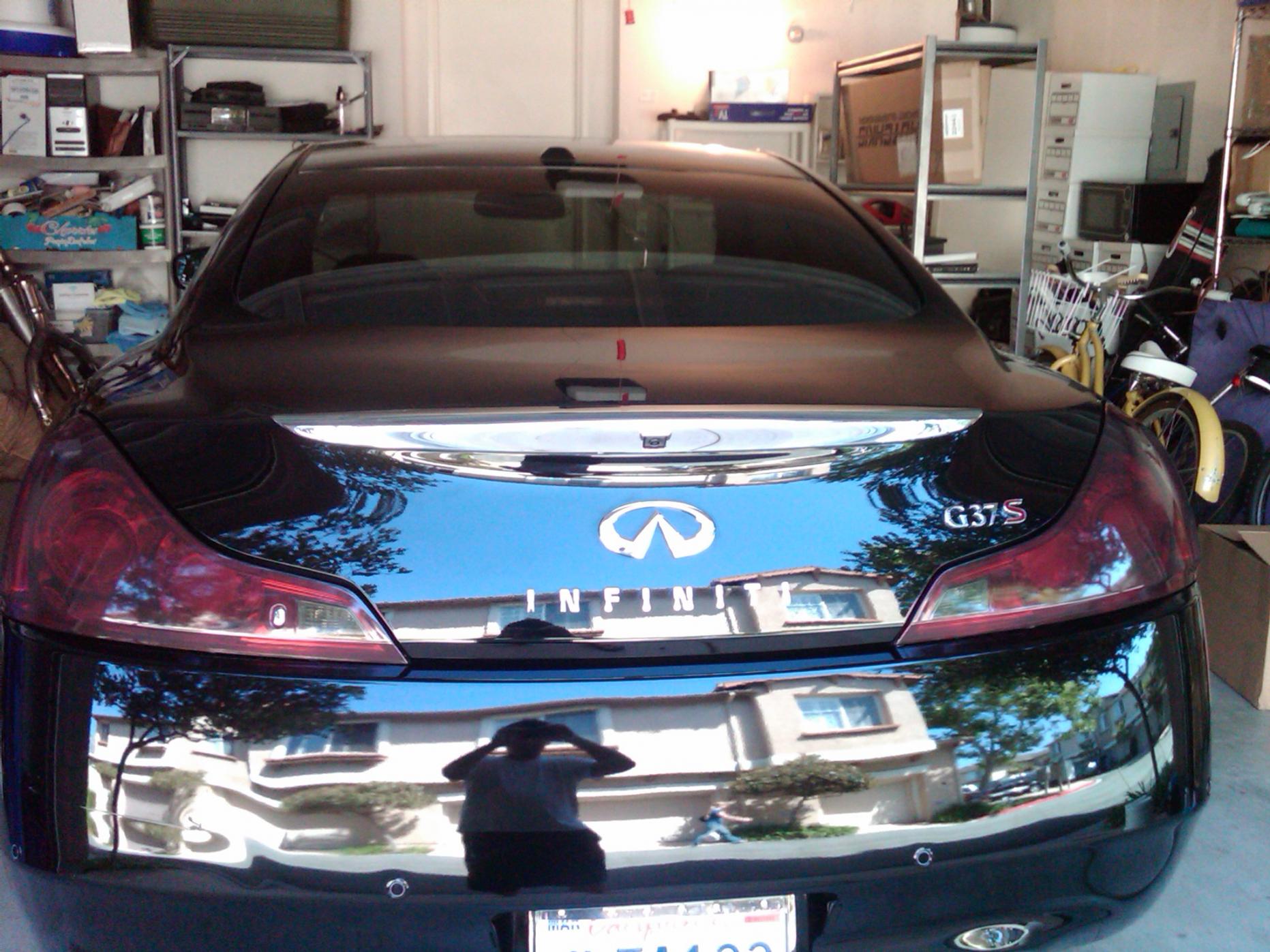

here is mine
Attached Thumbnails Blue Batmobile Overlay Thread. Post your pics here!-img00012-20100618-1538.jpg
