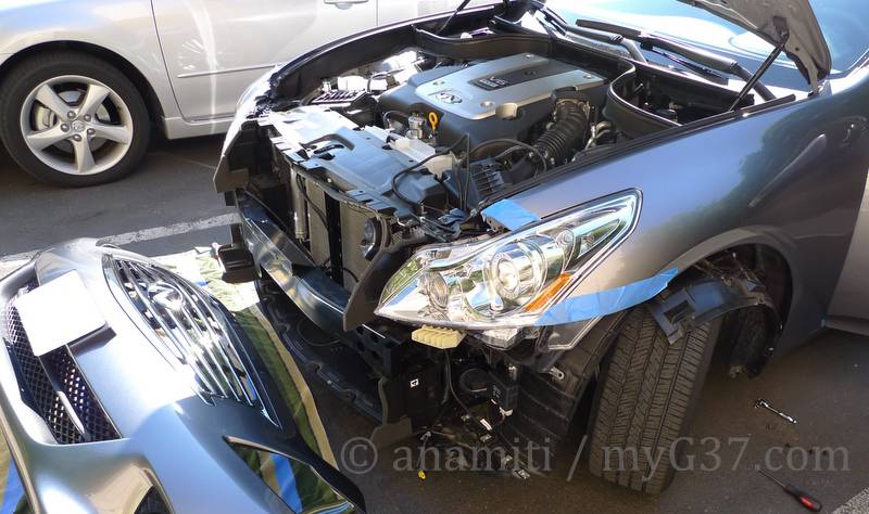

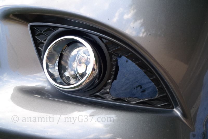

First post here (long-time lurker). After peschs3's thread on OEM Nissan "Hyper" Daytime Running Lights (DRL) for his G37xS, I couldn't resist taking it on as a project...
These are Nissan/Infiniti Genuine Parts that I ordered through my local Infiniti dealer. The part number for my car, a 2010 G37x sedan automatic transmission (non-sport), was B66M0-1NF01. List price was $724.90, but I paid $540. Note that there are two light module designs, Standard and Sport. For other part numbers and further information, please refer to peschs3's thread. He opted for dealer installation.
The package comes complete with everything that is needed, except some common tools and supplies. All wiring for the kit is accomplished through harnesses, so there is no splicing. There is a 19-page installation booklet (in English), which is quite good. It states that dealer installation is recommended. My dealership estimated a minimum of $500+ in labor, so I opted to do it myself.
The installation took me about eight hours. It certainly could be done in less time, but I was very careful to do everything exactly right. As a comparison, I have previously done the DIY paddle shifter mod, which took me an hour or two. Obviously, the DRL install was much more involved. The most time-consuming step is removing the front bumper and wheel fenders, especially if you haven't done it before. The installation instructions called for removal of the left front wheel, but this wasn't necessary for me. As you can see, it also requires drilling into the front bumper faux-vents. Overall, I would say installation was difficult but well within the capability of a competent enthusiast.
I am very satisfied with the results. The lights shine brightly during daylight, and integration with the car's electronics is seamless. I only hope that the LEDs last for several years. I did this install a month ago and there have been no problems.
I've got a weakness for sleek LED DRLs (particularly Audi's stunning designs), and this mod has rounded-out my G37 in that regard.
Now, I would love some LED turn signals (especially rear). Possible?
