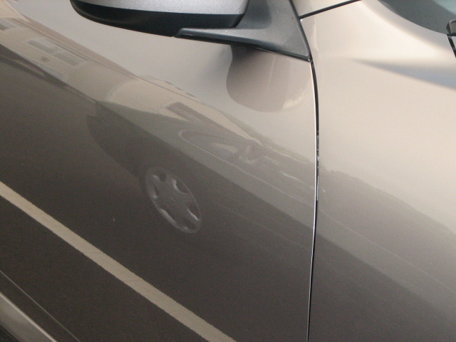

So its been 16 months, and today I got my first door ding on the drivers side. I have been parking in the same spots in my employer. So I come out of work today and boom I see this old *** beat up toyota landcruiser from like 1982 backed backwards, and all crooked, and with my luck today, boom a dime diameter dent. In the picture is kinda hard to see, but the car lines are so perfect and with and without the sun, you can see it. Is like 3 inches below the side mirror. So I searched and looked at PDR around here. What's the average price. Where do I go, Im in Northeast Jersey. Thanks.
Attached Thumbnails DAMN my first door ding.  When did it happen to you, how did you feel?-img_3996.jpg

Dent Doctor (or similar) paintless dent removal. They'll knock it right out in just a few minutes. You won't even be able to tell where it was...

Dent Wizard charged me $90 on my last car. That was about two years ago.

I called around, they dont drill holes. They use their special instruments to fix the issue. I called around here in Jersey, and I'm getting these quotes from $120-150. Anybody know a company or spot in the Northern Area of Jersey?

It's kinda hard to get a good look at yours, but it was pretty similar. It was actually kinda cool how they did it. They used a suction cup with weights on it. For my car the suction was on a different part of the door than the actual dent. and the dent just pops out. In all it took about 20 minutes, but that was with the guy taking his time. No panels removed or anything. He said it usually costs more, but they gave a discount if I met them at the dealership rather than come to my house. Also, They charge $90 for the panel, so if you have more than one ding they will fix them all as long as they're on the same panel.

They don't use a suction cup with weights. They suction cup a reflection board onto the car so they can see how they are manipulating the panel. Depending on where the ding is, they may have to drill a hole to get access...commonly done to get access to dings in quarter panels. The hole is only about a quarter inch and the tech should seal it with silicone and a grommet plug. They use rods with a spooned or rounded end to massage the ding out slowly from behind the panel. Some are better than others so you should be looking for a master tech. The best way to find a master tech is to call up your local mecedes/bmw or even Infiniti dealer and ask who they use. The right tech will make it so that you will never know the ding was there and the price depends on the damage. One ding is usually around $100-$125.

I had a long elbow/forearm ding on the quarter panel of my g35 a few years ago. I met with the tech and pulled the tail light , but he still had to drill a hole to get the right angle to the ding. They usually do it in an inconspicuous place, like behind my tail light or in a door sill. Most other panels don't require any drilling

Thanks a lot for the info! So for the ding in the door right below the sidemirror like 4 inches below, somebody else told me its very hard to take the ding out because its in the re-inforced door metal etc. Then another guy said no problem piece of cake, they just use this tool that goes inside where the door glass is, its cover with plastic, and even at that angle, location, they can use their devices. My question is, is any there any damage to wiring, glass, speakers, or anything since they are sticking this metal shape tool behind the glass door? Thanks for all your help info. I called infiniti, they used dent wizard, and garden state dent.
