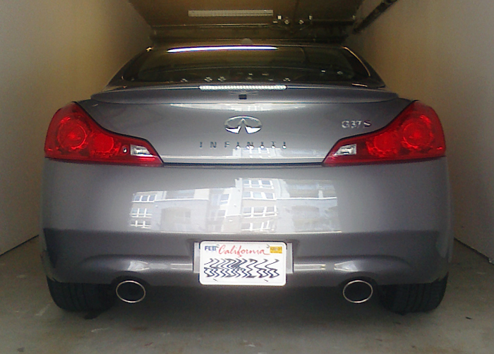

BS. I had to get my back bumper repainted from a hit and run when my car was 1 month old and the body shop I went to matched it perfectly. How much were they charging you to paint?
Attached Thumbnails Impossible to color match amethyst graphite?-cimg0116.jpg

See attached photo above. My body shop repainted the entire bumper, not half of it FYI. They didn't recommend trying to partially paint it. My body shop charged me $450 ($150 deductible).
