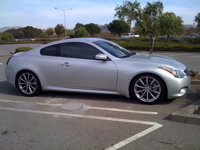

Hey all.
FINALLY DID IT!
PICS!
Im considering dropping my g37 on eibach pro kit springs, 1.2 f, .8 rear.
anyone have them?
do i need a camber kit?
and will i scrape anything thru normal driving (ie speedbumps)?
and do the stock 19s rub?
thanks!!!!

^installed today, alignment tomorrow morning =]
