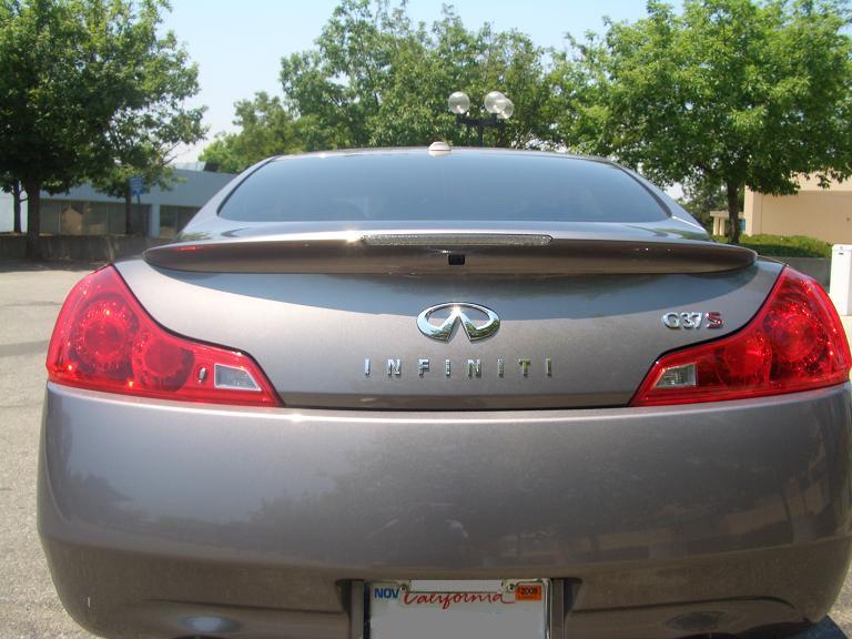

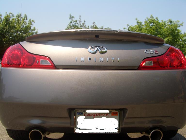

I just got mine installed and it came out perfect....looks exactly like it came straight from the factory....
it does not go over the chrome spoiler, you have to take the chrome piece off....for the unused holes, they give you plugs with the OEM spoiler, that will prevent leaking....I just got home right now and ran a hose over the spoiler and theres no leaking whatsover
as for the brake light, I have 4 of them now, 2 rear brake lgihts, 1 spoiler lamp, and 1 on the rear deck panel, and they all work...i was thinking of buying the kit to replace the rear deck panel, but after seeing all the lights on, it doesnt look bad at all...sort of sets it apart from the stock spoiler cars...
also in addition to double sided tape, you do need to drill holes, for clips to plug into...its not just the tape.
overall its awesome! no difference between this and the factory equipped car, except the additional brake lamp....

pics after install
Originally Posted by jtree007
Pictures????
pics after install
Attached Thumbnails OEM Spoiler & Rear Deck Panel Now Available-cimg4994.jpg   OEM Spoiler & Rear Deck Panel Now Available-cimg4995.jpg
