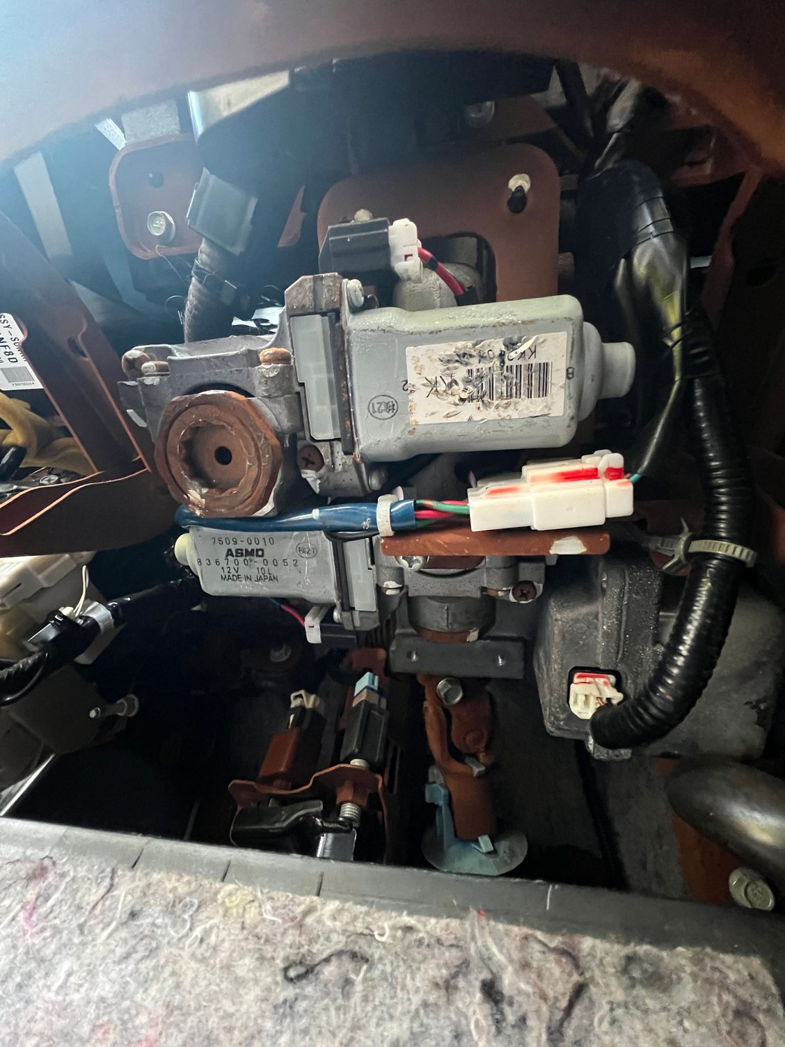

This is the one from the videos.
This is how it looks in my car
I’m very new to infinitis and really can’t find a way to get it removed. And I’m wondering if the bolts are above it someway? The video looks super easy to remove but mine is like positioned differently.

Originally Posted by thanyc
... can’t find a way to get it removed. And I’m wondering if the bolts are above it someway? The video looks super easy to remove but mine is like positioned differently.
There are two anti-theft "breakaway" bolts that hold the module to the column. These bolts will not have a head where you can easily remove them. It will be VERY difficult to the get them out. Most folks use a small chisel and hammer to loosen them while others use a small dremel-type tool to cut a notch in the top of the bolt and unscrew it out that way. Thankfully these bolts are not super-tight so it should come out easily once you get them broken loose.
