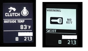

Edit.. Amber key light? Can you post a pic?
Old Jul 7, 2018 | 06:02 PM
JSolo's Avatar
JSolo
Just say no!!!!!
iTrader: (14)
Joined: Oct 2011
Posts: 6,103
Likes: 594
From: People's Republic of IL
It's possible to depress the start button without the key present but the car won't start.
You get the image below (on the right).
The left image is what I see trying to start the car without the clutch depressed.
