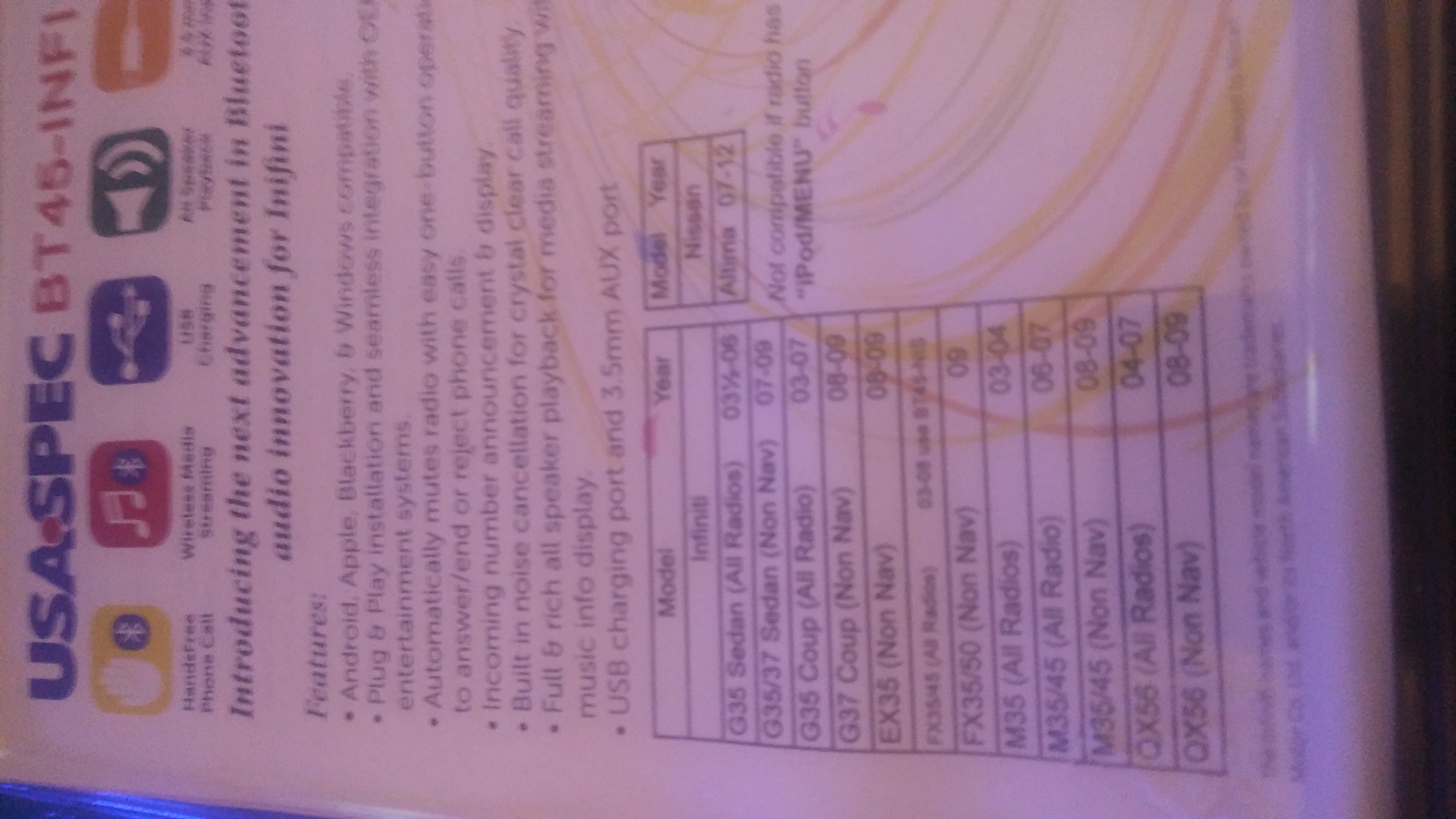

So I guess I was one of the lucky ones that bought a 2010 coupe that doesn't have USB or 3.5...just the RCA in the center console... Nor do I have Bluetooth
So from doing my research it was up to the Grom or BT45 and I picked the BT45 because it just had better reviews...thru looking Google and on websites like Crutchfield they all say that BT45 would work up to 2011.
My question is now that I've ordered it I get the damn thing and it says on the back of the box that it's compatible w the 08 and 09 coupes w non Nav..
Well what about the 2010 what's the difference in my crappy setup from my 2010 non Nav and a 09 non Nav? Will I be able to get this thing installed?
I've heard of other 2010 non Nav having Bluetooth streaming and having USB ports and people being able to use there iphone and stuff.. I don't even have the ability to plug a USB drive in and listen off of a thumb drive like some.. my car has none of that, has anyone ever had success using the product in a 2010 bare bones like mine?
I'm supposed to take this thing to get installed tomm and I'm afraid dudes gonna give me the thumbs down..
Can someone please help me out and let me know if I'll be good or not. Thank u so much

Just so everyone knows.... Its installed, It works perfectly w the 2010 & 2011
Hooks up too Pre wired XM output in the trunk... Very clean... Now I have RCA, USB and Aux.... So I'm in a better place then if I'd have gotten it from the dealership...
Only noticeable difference is that listening to streaming audio via Spotify on my LG G5 vs my IPhone 6s plus, the iPhone is louder.. I'd say by about 20 percent. Very odd, I tried turning up the volume all the way UP on each device while having the volume down on the radio, then turning back up.. Still the iPhone is much louder.
now I have hands free calling and audio streaming and I didn't before....now I don't have a bunch of little crappy plug in adapters too listen to the music on my devices

Its in the very front of the trunk to the right..pull up the mat to expose your spare ..literally look down you can't miss it, it's to the right
I had mine put in at a car audio place
If you want directions just do a Google search for directions for USA spec bit-infi45
