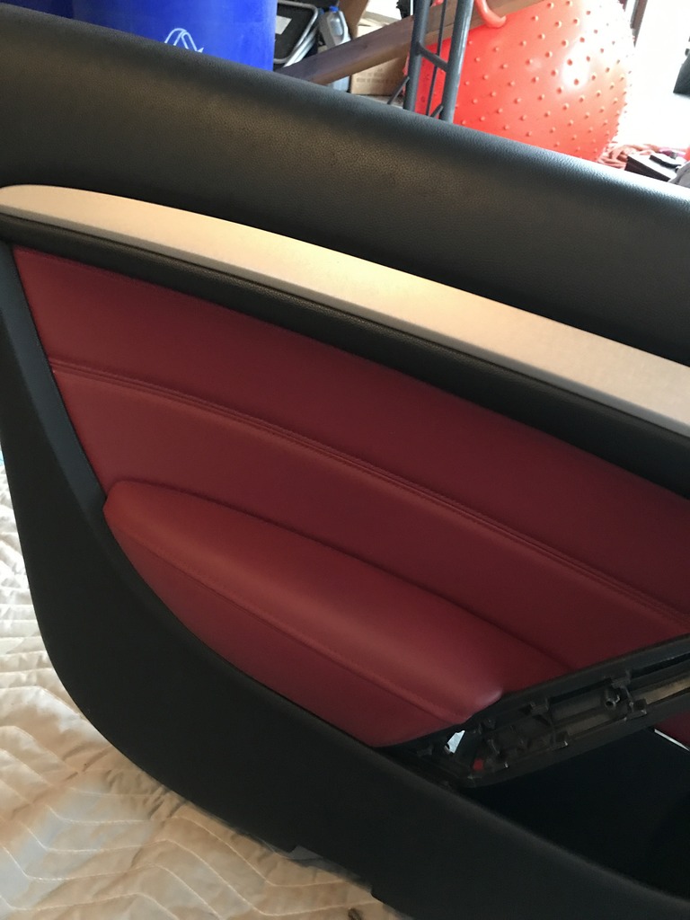

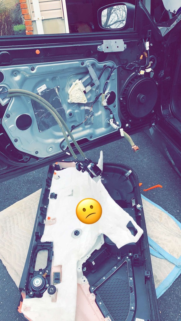

Hi everyone - I took off my door panel on my G37 2008 Coupe because I wanted to replace my black interior panels to monaco red. It was a relatively easy process, but now I'm having an issue when I re-install it.
I disconnected all the wiring and reconnected everything, (only driver side panel). Both windows were open. When I went to close the windows, both wouldn't close. I disconnected the battery and turned on the car and only the passenger side would close. The driver side wouldn't close.
I'm lost at what it could be right now. Any help with this issue?
I don't think it's the fuse box because the passenger side worked when I disconnected the battery. I don't know what's going on
Here are pics

Hi sorry - I needed the close the door to reset everything. I just wanted to quickly close the window by plugging in the wiring, but the entire door needed to be shut, (i.e., needed to fully install door panel to close door properly to reset)
