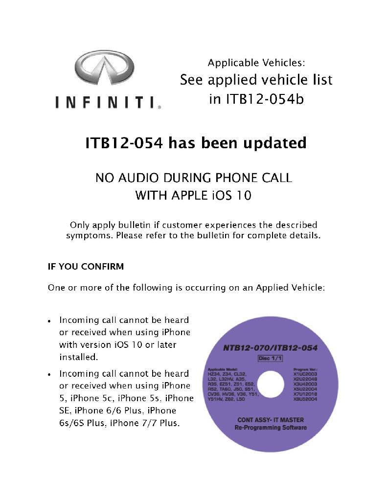

Infiniti has updated a TSB to address iOS 10.x issues. Refer to ITB12-054b (see attached).
Attached Thumbnails NEED HELP FROM FELLOW IPHONE USERS G37 not compatible with iOS 10.1.1-itb12-054b-dealer-notice.jpg
