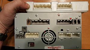

WHAAAAAT!?!?!? If we're looking at the attached picture; are you saying the plug on the right of the box on top and the plug on the bottom right of the AV unit can be accidentally swapped??
I don't have the NAV system in my vehicle so I can't stream music from my android phone. I was looking for an alternative and stumbled upon Grom Audio and didn't have much luck with it. My car is currently in the shop being diagnosed because of the dash and AC problems! The guy is saying "the meter amp is shorting out the system". Could I have messed it up by swapping the plugs?!?
YES!!!
THEY CAN BE SWAPPED!!!
That's why the plugs that go into the AC amp are marked with a yellow tape...
Connect the plugs correctly and it should be OK... if you didn't mess up something else while trying to fix the problem...

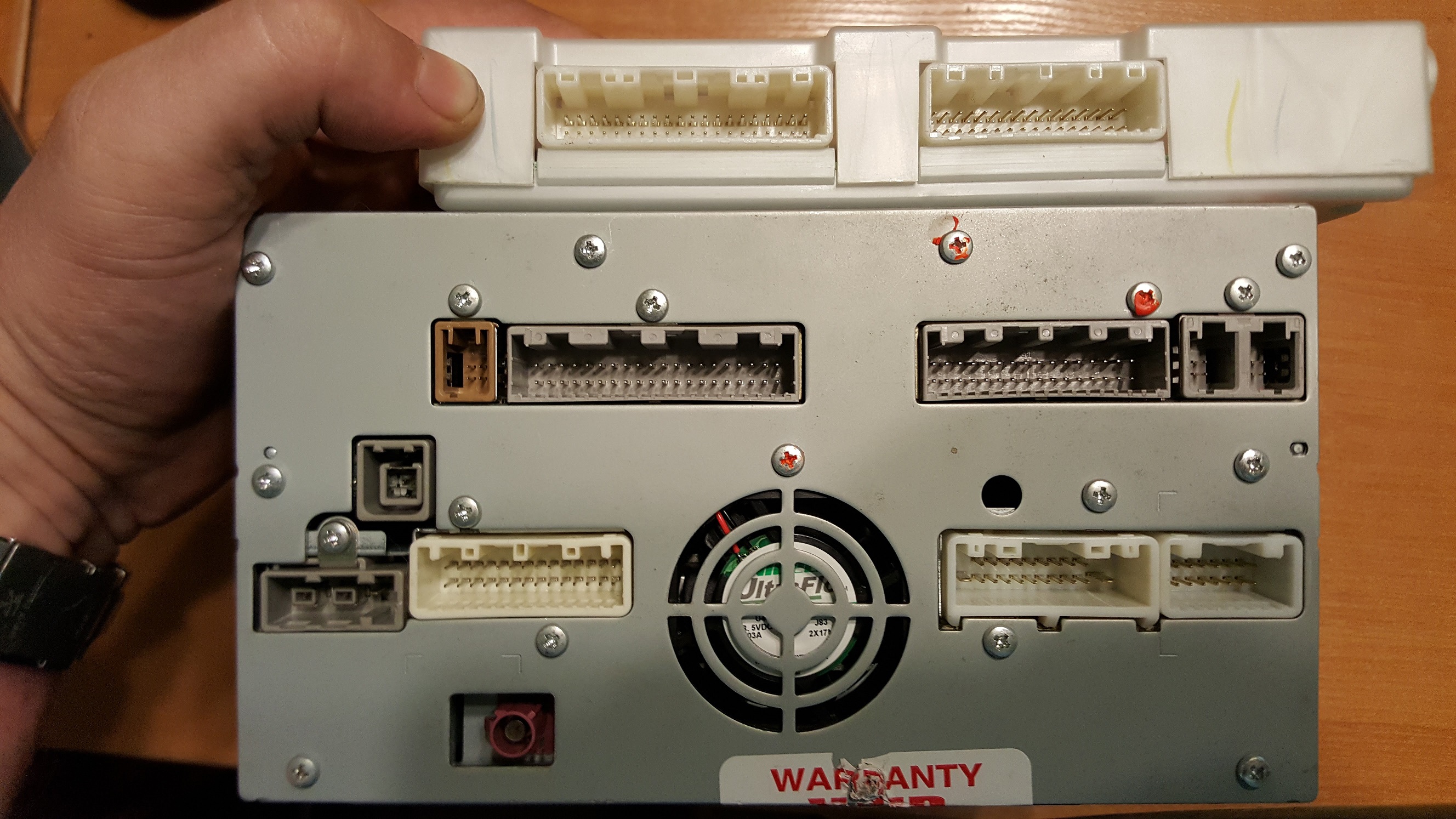

LOL just check them out on a NAV unit too
You can swap even more
Attached Thumbnails Cluster/ gauges not working-20170929_232033.jpg
