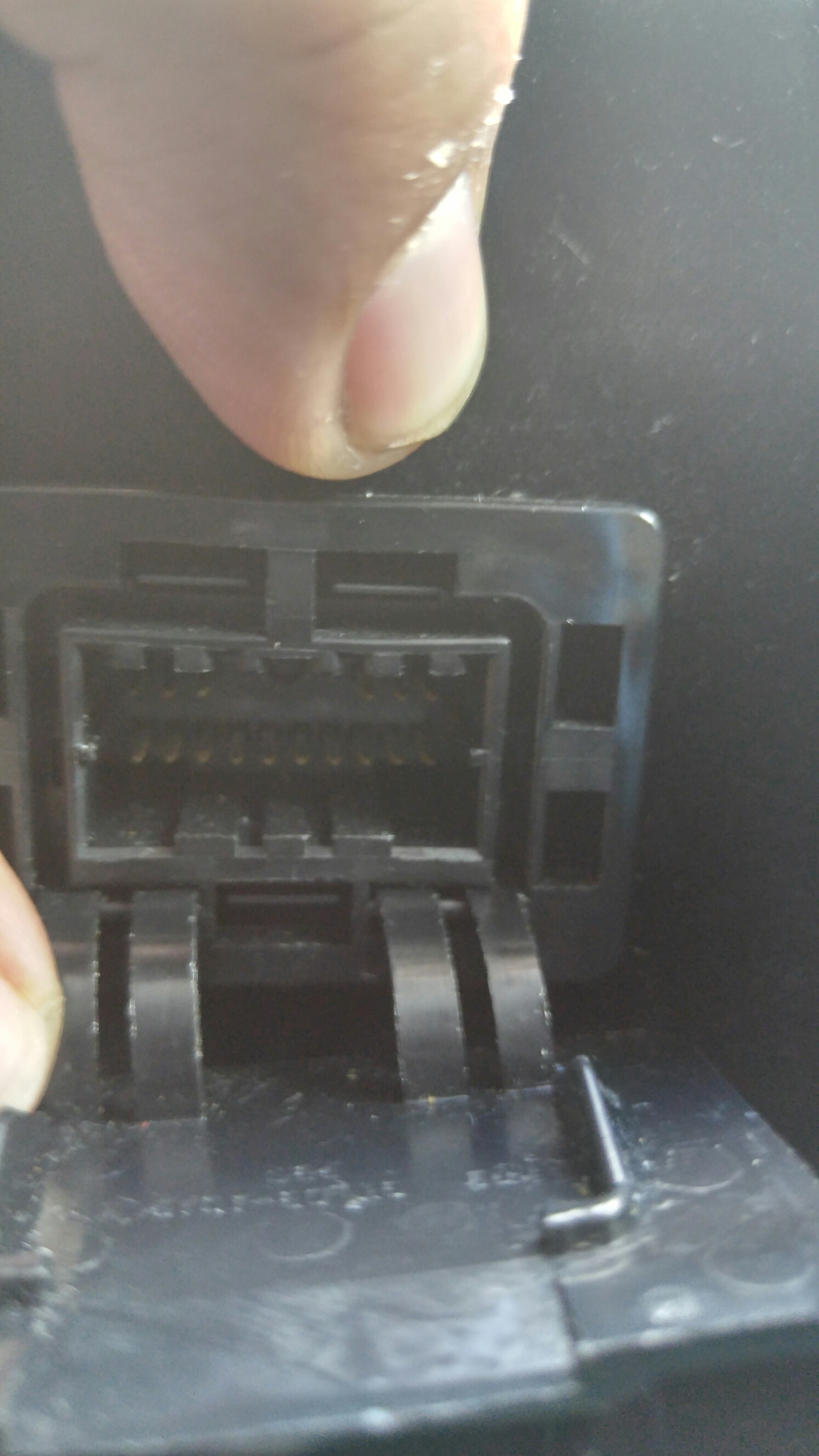

Well it looks like there is a piece missing in the arm rest ill get a pic.. And it does have the download capability.. No load button..

Ok. Thanks to the pdf file.. No usb.. Just a stupid apple connection... Aaargh
So i just gonna use my headphone jack to connect thru the aux.

Im no expert, especially on a '09. But that definitely is not an apple connection. Looks like a wire harness that you would find behind the radio. I would guess that it is not stock. If you get some time and feel up for it, I would pull your armrest apart and see what is really in there.

It is an apple connection, there is a proprietary plug for it. I searched it out.. But since i dont have any apple stuff no need to spend the $40.. Lol

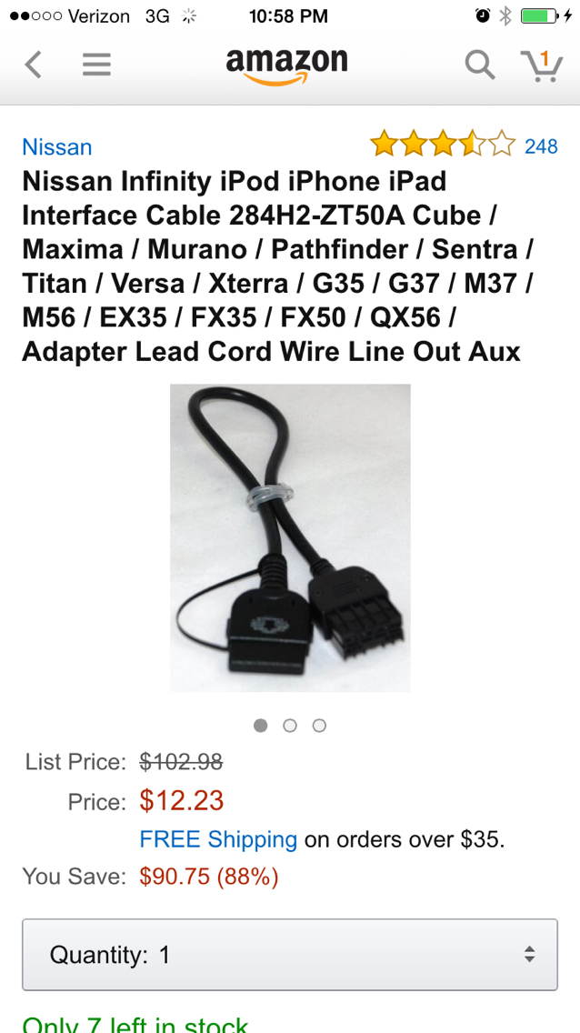

wow, that is weird. a cable to plug your Apple cable into. its only $17.95 on Amazon ...
Amazon.com: Goliton® Nissan Infinity iPod iPhone iPad Interface Cable 284H2-ZT50A Cube / Maxima / Murano / Pathfinder / Sentra / Titan / Versa / Xterra / G35 / G37 / M37 / M56 / EX35 / FX35 / FX50 / QX56 / Adapter Lead Cord Wire Line Out Aux: Compute Amazon.com: Goliton® Nissan Infinity iPod iPhone iPad Interface Cable 284H2-ZT50A Cube / Maxima / Murano / Pathfinder / Sentra / Titan / Versa / Xterra / G35 / G37 / M37 / M56 / EX35 / FX35 / FX50 / QX56 / Adapter Lead Cord Wire Line Out Aux: Compute
to be honest, that adapter and a used ipod are probably your best bet for music if you dont have Bluetooth. useless you like ****ing around with CD's like its 1984.

Sweet thanks.. Unless im missing something.. Which i probably am... I cant seem to use my bluetooh to play music.. Only to make calls..
Thanks for finding that cord cheap.. My wife has an old ipod i can use.

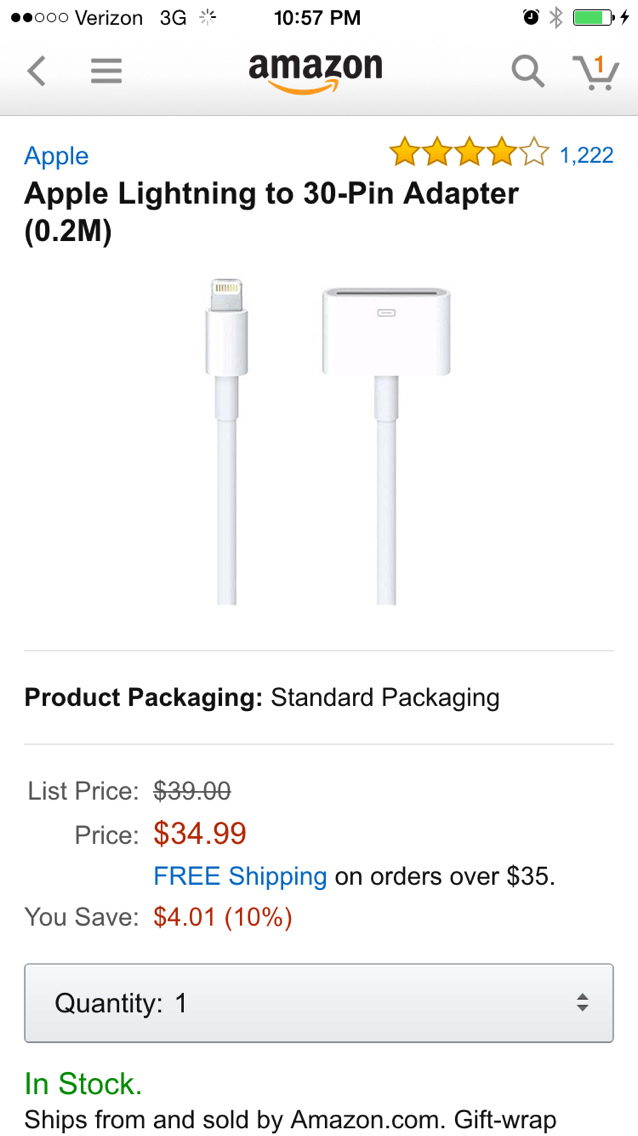

There no USB on the 09 they have a iOS cord that you can plug into the inside of the arm rest in that picture you showed. You would need a Infiniti/Nissan iOS adapter and then a if you have a iPhone 5 and up or a iPod with the new smaller pin you also need a iOS adapter from small pin to update one.

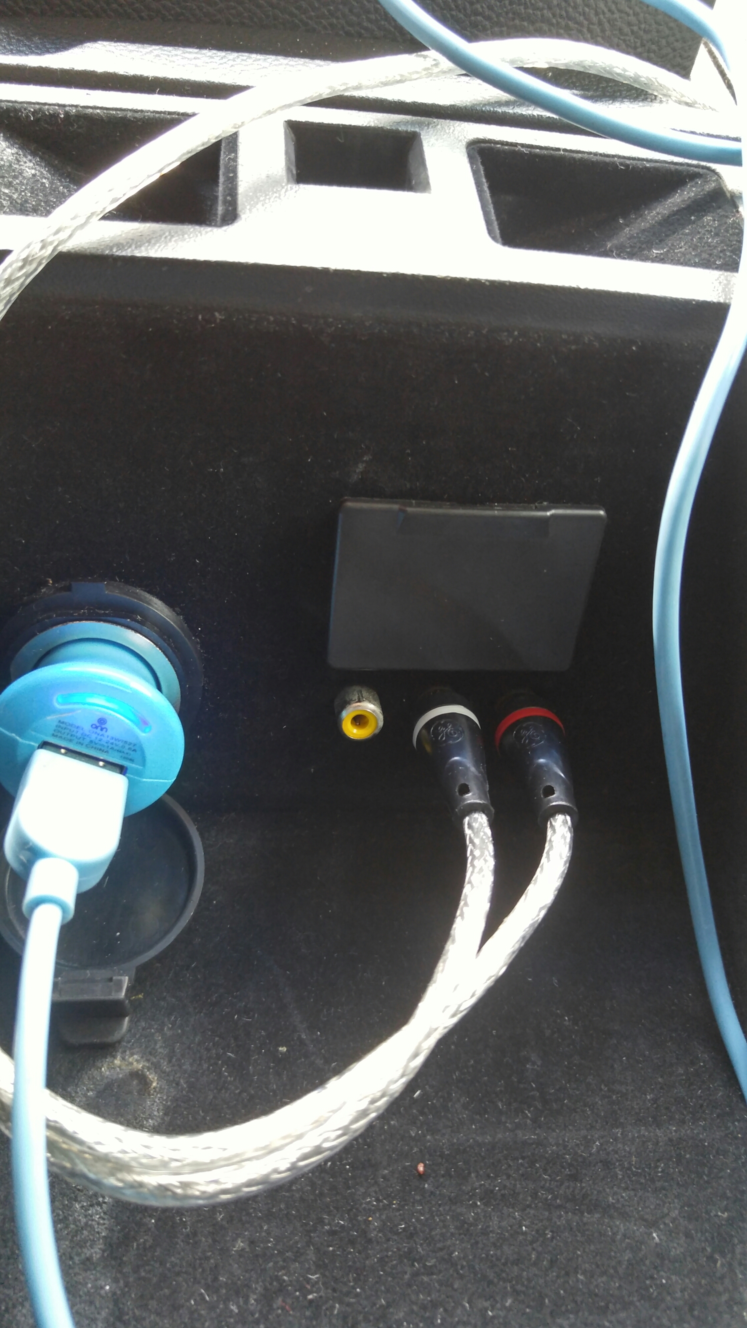

another very roundabout way to get Bluetooth music from your phone is to get:
USB Bluetooth adapter
Amazon.com: (Smart & Portable) MINI USB Bluetooth 3.5mm Stereo Audio Music Receiver & Adapter for Home Stereo , Portable Speakers , Headphones , Car (AUX In) Music Sound Systems , and more 3.5mm Media Devices: Automotive Amazon.com: (Smart & Portable) MINI USB Bluetooth 3.5mm Stereo Audio Music Receiver & Adapter for Home Stereo , Portable Speakers , Headphones , Car (AUX In) Music Sound Systems , and more 3.5mm Media Devices: Automotive
12V-USB power adapter
Amazon.com: BIRUGEAR Metalic Black 2-Port USB Car Charger Adapter 2A output for Cell Phone, Smartphone, iPhone, Tablet, MP3 Players, Ebooks, e-Reader: Cell Phones & Accessories Amazon.com: BIRUGEAR Metalic Black 2-Port USB Car Charger Adapter 2A output for Cell Phone, Smartphone, iPhone, Tablet, MP3 Players, Ebooks, e-Reader: Cell Phones & Accessories
mini-RCA cable
Amazon.com: Cmple 3.5Mm Mini Plug To 2 RCA Hook Computer To Stereo, Ipod - 6 Ft: Electronics Amazon.com: Cmple 3.5Mm Mini Plug To 2 RCA Hook Computer To Stereo, Ipod - 6 Ft: Electronics
plug 12V-power adapter into 12V socket
plug Bluetooth adapter into 12V-power adapter to power it
plug mini end of cable into Bluetooth adapter audio out, and RCA end into car
pair phone to Bluetooth adapter
had to do that in my '08 Evo, which does Bluetooth calling, but not audio.
this at least keeps all cords out of sight in the armrest.

Landshark's suggestion is what I did. Loaded a bunch of music on a iPod lying around and keep it in the center console. The mass of wires is not pretty, but it's out of the way.

you could also do the above - Bluetooth the ipod to the mess of wires and adapters in the armrest, and vent mount the ipod so you can change tracks/see what's playing. you would only need to connect a charge cable to it when it needs charged ...

iPod is already in center armrest and charging. I see everything on the main screen so no need to have iPod mounted anywhere. It's a clean set up- so long as you don't open the armrest
