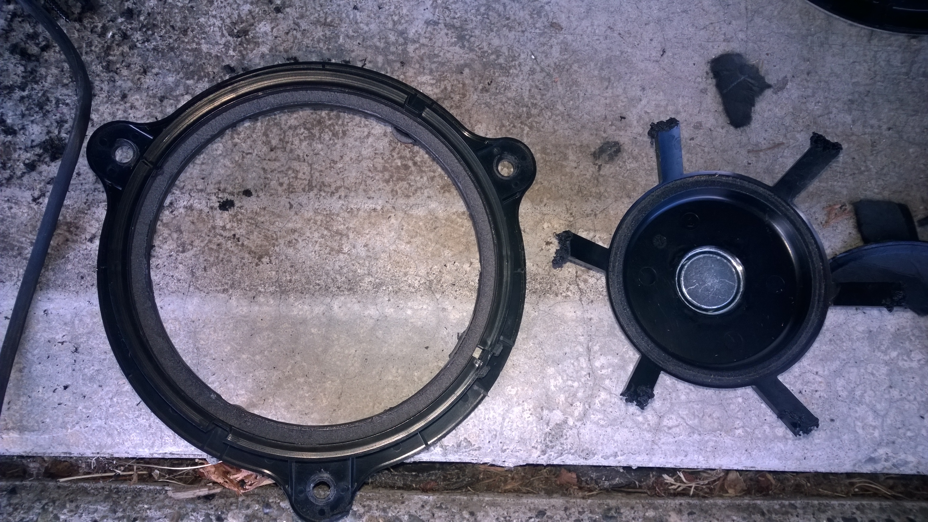

I recently replaced the rear door speakers in my 2009 G7X Sedan. I noticed while looking for information on all these sites that nobody really ever definitively answered questions about the size of the speakers. I have just the base stereo, without Bose. Both front and rear are close to 6.5" I think but definitely what fits back in. I replaced the rear with 6.75", I think the 6.5" would have worked better since I used the stock speakers as my mounting brackets. If you have the base radio (non-Bose) you shouldn't need to buy any aftermarket brackets, and after seeing the stock speakers, I don't think it would be worth it to keep them and sell them, they are very cheap. I am going to attach a couple pics to show you what I did. Once I removed the stock speakers, I just basically pulled it apart and using a dremel tool, I cut out the plastic parts that were in the way and set the speaker right down inside the stock speaker and screwed it in place. Before doing that I added a little bit of weather striping for padding. I am not a professional installer by any means, but I have notices there are a lot of questions and people looking for speaker brackets or having a professional installer fabricate something, you really can use the stock speaker with this easy modification and do it yourself. And just a note, I have the base stereo (non-Bose) and all 4 door speakers were identical, so if you have the non-bose you can use the stock speakers in all 4 doors to do this. Also a note, I had a shop install the amp and front speakers which included the sound deadening material you see on the back doors.

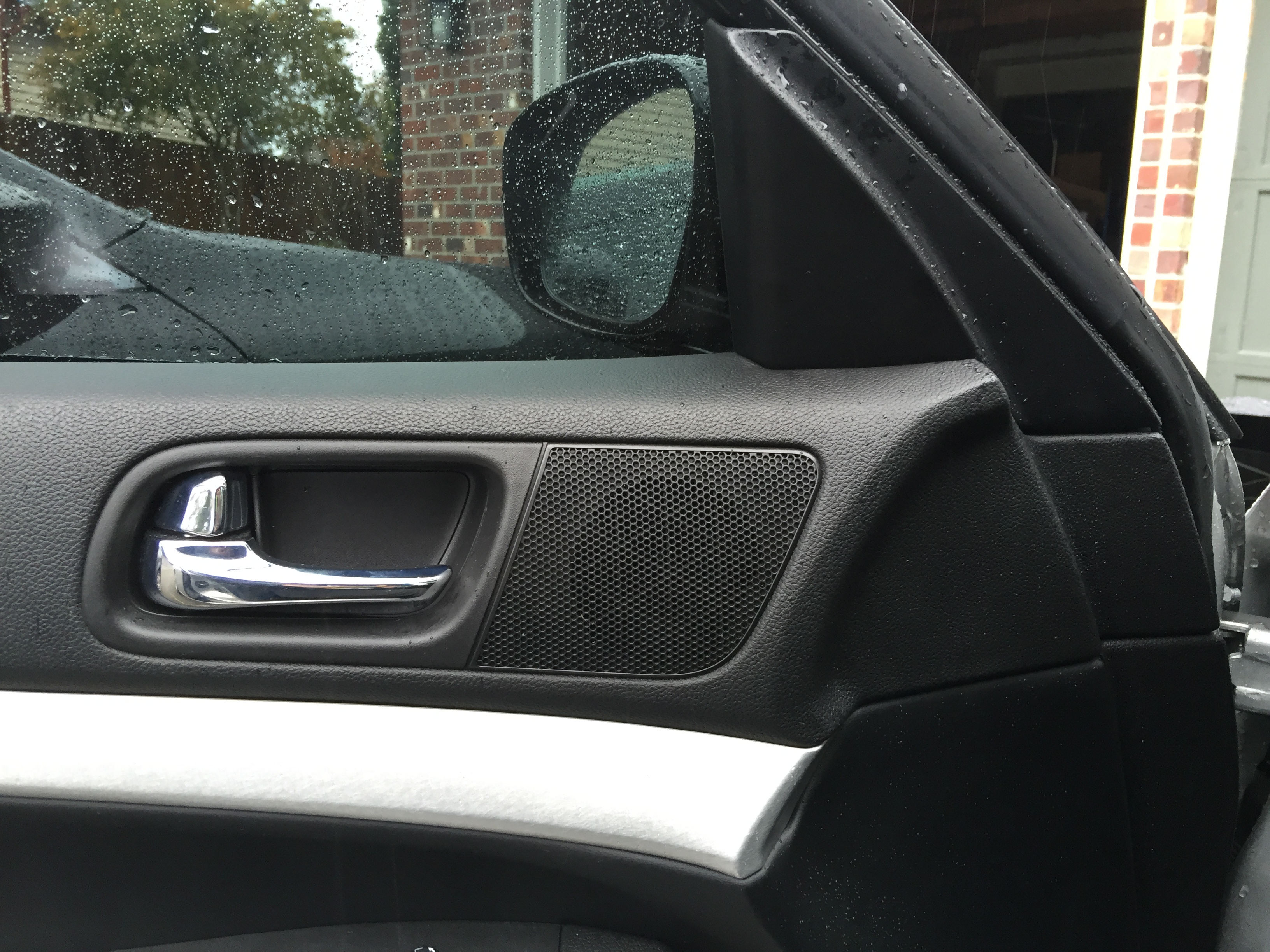

Ok, the guys who installed this did a sucky job, had I known they were going to install it the way they did, I would have done it myself, I could have hacked it up that bad myself, it took them 8 1/2 hours the first time and they screwed up the whole thing, anyway, they put the amp under the carpet on the passenger side floorboard, I would have put it in the back where the Bose Amp goes and that is what I thought they were going to do, the B4 is a pretty small amp and I think it would have fit back there pretty nicely. The other issue, is they put the tweeters in the sail panel, but he didn't measure them before cutting a hole and putting them in, it wasn't until he was done and went to put the door panel back on did he realize the tweeter was half way covered up and since it has a pretty good gap there now, they are sending me the replacement panels and I am just going to move the tweeters to the stock location in the door.

The ones that are in there are free and they work! But, I do have a question though, since I didn't put the tweeters in and haven't taken the front door panel off myself, I had at one point found the part number, I think it was Metra, for the tweeter adapter brackets to put a tweeter in the stock door location, now it seems that I can't find the link anymore, anyone know what that part number is or if I can just use a simple metal strap to put them in there?
Adding some pics for the tweeters
Ok, so I fixed the tweeters today, again, the disappointment with the job the so called professionals did, loose and stripped screws, they had the wrong ones in the window track that they took out which were loose since they weren't the right ones and causing the window track to thump when the window was down. Fixed that. Also surprised to find factory tweeters, still in and yes, still connected, why would you mess with the cover for the mirror to put in the new ones and leave this crappy little speaker in there? I tell you that the sound is once again improved, the issues I had in sound when using the tuner and radio I think are related to the double tweeter setup, the sound is much better now. So my question is this, I just put the tweeter in a thicker piece of cardboard, which I painted black and put some double sided tape on, this should be good enough right? There shouldn't be any need for me to go in and make something better out of plastic or something else? It is very secure in the cardboard, yes, ghetto maybe but it does the job. Oh, and as you can see, I cut up the old tweeter and just mounted the new tweeter in the cardboard, I left part of the old tweeter that held the old magnet on as tabs, in the future if I want to add a different tweeter or mount it some other way, I left them in there should I need some backing or support. I am liking hacking up the old cheap speakers!
