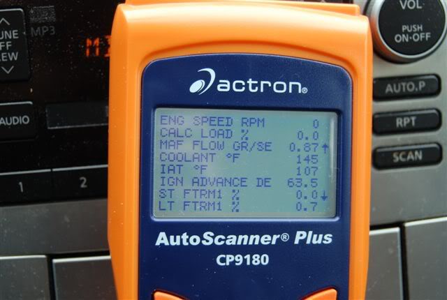

You could always get one of these
Telcoman

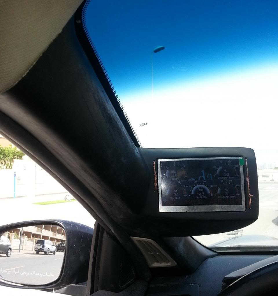

In that case, look into a 1.5" screen that you can basically squeeze in your ashtray or sunglass holder:
Zada Tech - Oil Temperature OLED Gauge
These are the same guys that did my gauges but I'm not sure you'd be interested in an A-Pillar screen like this one
