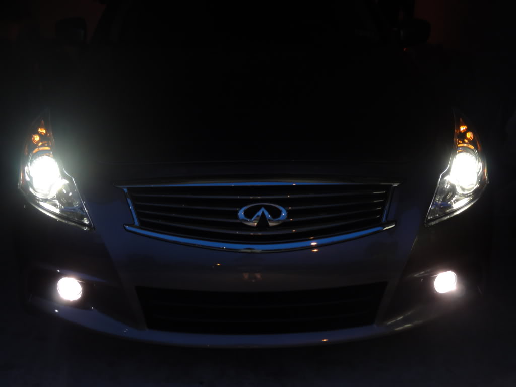

it does work, I put in led's so that it would be white/clear even during the day, but they blink twice as quick now, not sure but think it may think there is a bilb out. Going to try regular 7440 ambers tomorrow on the other side because I ran out of daylight. I also changed out the fogs to PIAA's while under the car and match pretty good and more reliable in my opinion the hid conversion

The piaas are the extreme white h8 bulbs. And as far as the single element yellow 7440 goes it looks the same as the stock bulb but only lights up with the the blinkers. Going to find some error free LEDs or add the resistors.

final result with PIAA fogs and led 7440 yellows thought the rapid turn signal is annoying it is better than having a yellow 7440 nonled in there at least in my opinion. I will add resistors or get the error free bulbs at some other time.
