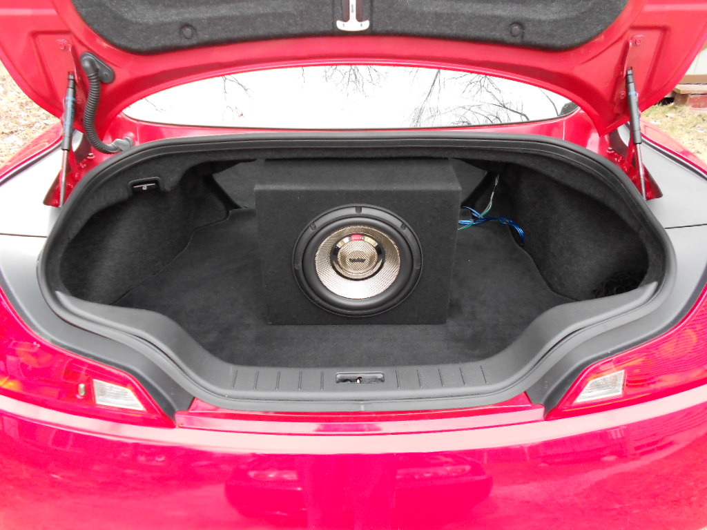

My Bose system was plenty loud enough in the mids and highs area. Low end was lacking. I took care of that for about $400.00 It sounds beautiful now. Just enough low end for decent fill, and the stock Bose soundstage at full volume with no distortion is perfect.

^what set up is that?
A simple 10" Inifnity Kappa 10" in a 1.0 cubic foot sealed enclosure with about 500W RMS available to it. I removed the 6X9 subwoofers from the deck lid, and tapped the high level inputs to the amplifier.
How much room did you lose in your trunk with that setup?

Originally Posted by Dio
That's definitely a consideration, need to look into the options. Thank you for the suggestion!
About 1 cubic foot worth lol. I can quick disconnect the box/amp in about 2 minutes if need be.

Originally Posted by YewWanSum
Are you running an amp?
Yes. As I stated in my reply.
Which one may i ask?
An old school JBL BP1200.1
