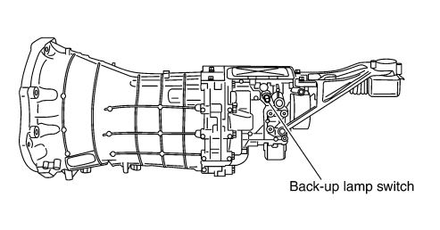

It's in the same spot as the 350z, but I don't know if theres more or less space for you to get your hands or a socket in there when you get the car jacked up/on ramps.
It's on the driver's side of the transmission.
