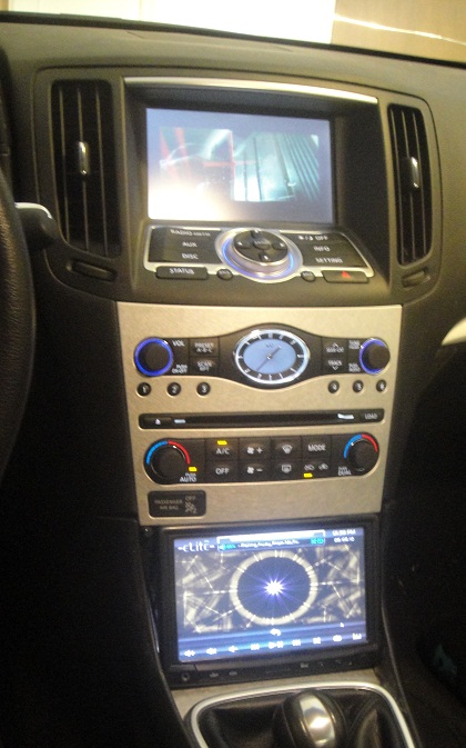

Originally Posted by fuzemagazine
What was the outcome?
Awesomeness!
The top is video (all my music is ripped from YouTube video-grabber now) or Garmin MobilePC Navigation.
The bottom touch-screen is for browsing music/movies/tv/weather/internet or playing WinAmps MilkDrop Visualization.

Old May 5, 2010 | 04:38 PM
RPMsG37's Avatar
RPMsG37
Joined: Mar 2008
Posts: 43
The list is pretty much just one part... a VGA touch-screen that can fit between those 2 pillers. I got this one off ebay for like $140 two years ago. You just need to measure and check the outer dimensions.
The ash-tray part can be easily removed and the wires to the lighter-plug can power the LCD.
I took the back plastic off my LCD so it would squeeze in to the hole better.
While the dash is open you need to do the video-while-driving mod (you cut the tachometer wire plus cut & ground the parking break wire).
Then you simply pop a PC in the trunk that has VGA output for the LCD, USB input (for the touch-screen), and video/audio output for the stock-screen/sound line-in at the center-console. I removed the iPOD jack (since I don't use it) and ran the 3-RCA's for A/V through that hole and under the carpet to the trunk where the PC is. I have a USB hub in the center-console too.

You can use any PC that you want. It doesn't take much power.
I am running Windows 7 Ultimate using Ride-Runner as my CarPC frontend and Garmin Mobile PC as my GPS Navigation.
The PC is a P4-1.2GHz with 1G RAM.
Built-in Video/Audio (with RCA-video-out)
USB-WiFi / USB-GPS / USB-DiNovo Mini Keyboard
32GB SSD drive (actually a CF Card that it can boot off of).
(I used to just use an old 20GB 2.5" 20GB laptop drive).
USB 64GB Flash Key (plugged in to hub in center console) for holding up to 4000 YouTube HQ Music Videos (free to download all you want).
System auto-connects to internet for live YouTube/Hulu/Pandora Streaming if I plug my phone in to the USB hub in the center console, or if I turn on my phones WiFi-router mode, or if I am within a block of my house/work WiFi. With internet it also does webbrowsing, e-mail, weather, traffic, gas-prices, skype, and navigation through Google Earth.
