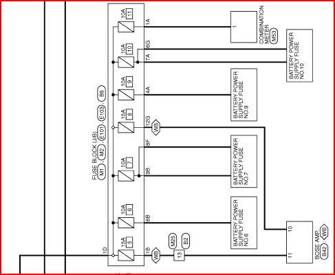

After a few days of noticing low bass levels in songs I had heard several times in the G, I switched the fader to Rear and all I got was treble!! Pretty sad that my extra 100 Watts of Bass is just gone but soon it shall be fixed!
Has anyone else had this happen yet?
Edit: Fixed! Changed the 15A fuse for the Bose Amp and whallla, back on! What a difference in the sound now!
Maybe you didn't realize, but you have two amps with the premium system. MOst likely, the small amp, which powers the 6x9 woofers on the deck, was blown and replacing it allowed the amp to operate again. The lack of bass was because the rear sides are only 3.25 inch mid range speakers with the rear deck 6x9 providing the lower bass octaves.
I realized, but on the fuse panel it says BOSE Amp, so I replaced that. When I think about it now I'm not really sure if it was blown since many other people have started saying there not getting a lot of bass from the rear deck like the G35s. But now I have a W6 in the trunk so got plenty of bass!

Just an update, yes, two amps (bose and subwoofer), and looks like two fuses for the Bose system overall.
