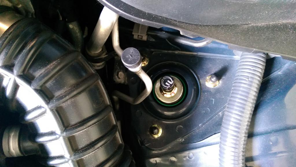

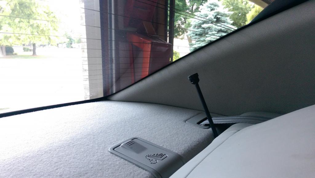

I have had these coilovers installed on my 2009 G37xS sedan for about two weeks now. As has been indicated in another thread, the packaging was excellent, and they appear to be a quality product. All the adjustments work well, the install was straight forward and nothing needed to be modified to fit. THMotorsports was great to work with, it just took a little longer than anyone planned to actually get this developed. But hey, I'd rather wait and it be right versus rushing out a crap product. So no complaints here.
I decided to get the Swift spring upgrade, had street valving and the rear adjustment extenders. 11kg/mm front, 8kg/mm rear spring rates.

The OEM rear spring setup is a little different than other coilovers I have seen for our cars. The rear spring still sits in the OEM location, but there is an adapter that the spring sits in. Guess it was easier to develop as it appears to be the same type of spring that is used in a truecoilover (versus the bigger diameter OEM spring).

Yes, you are correct, you need to use the wrenches to adjust the height. The rear is a little trickier to change because the spring and damper are not together.
