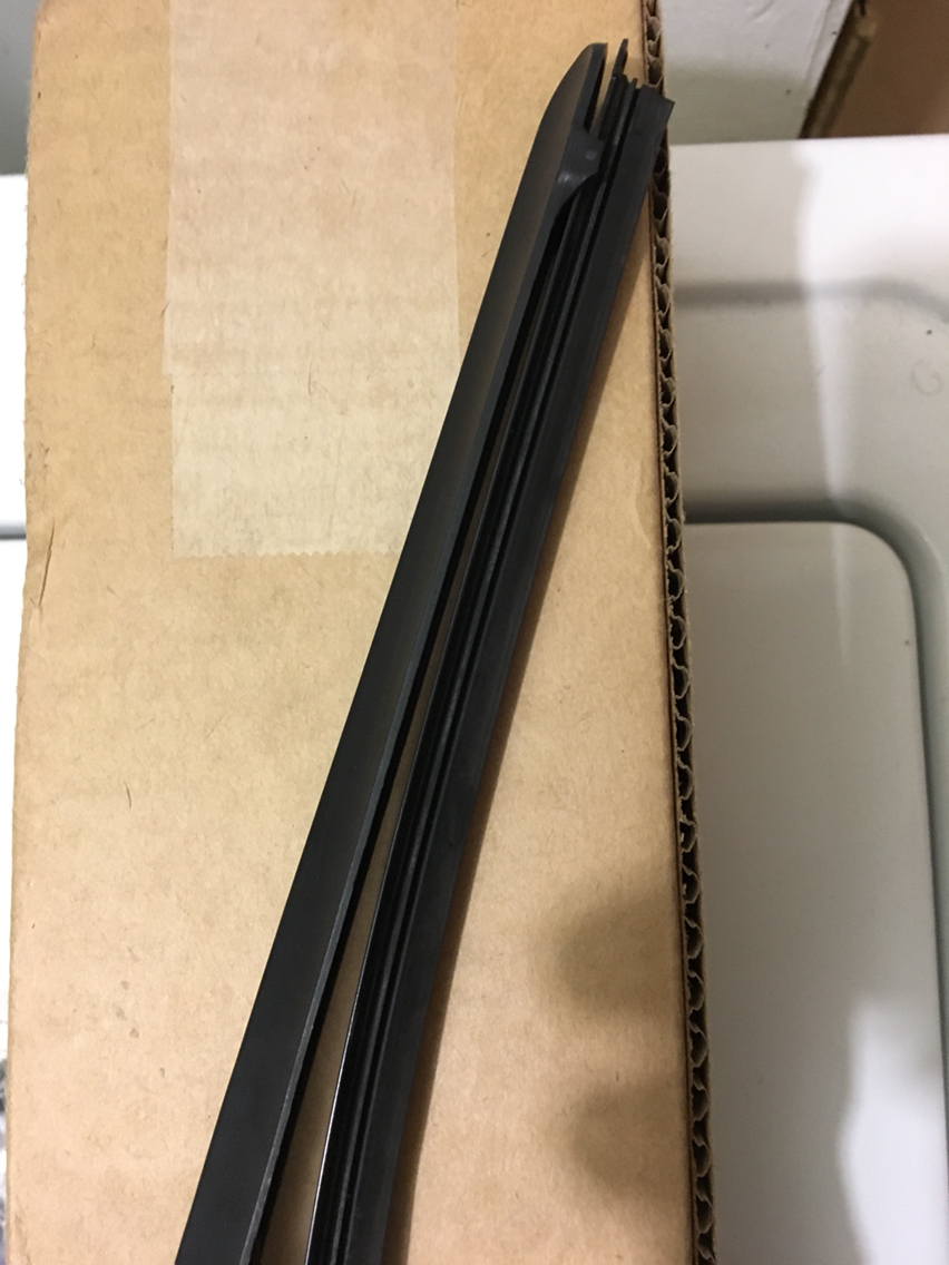

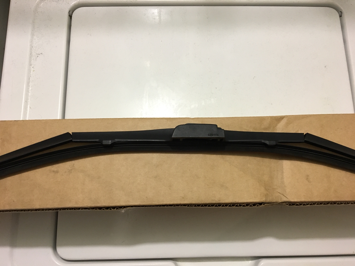

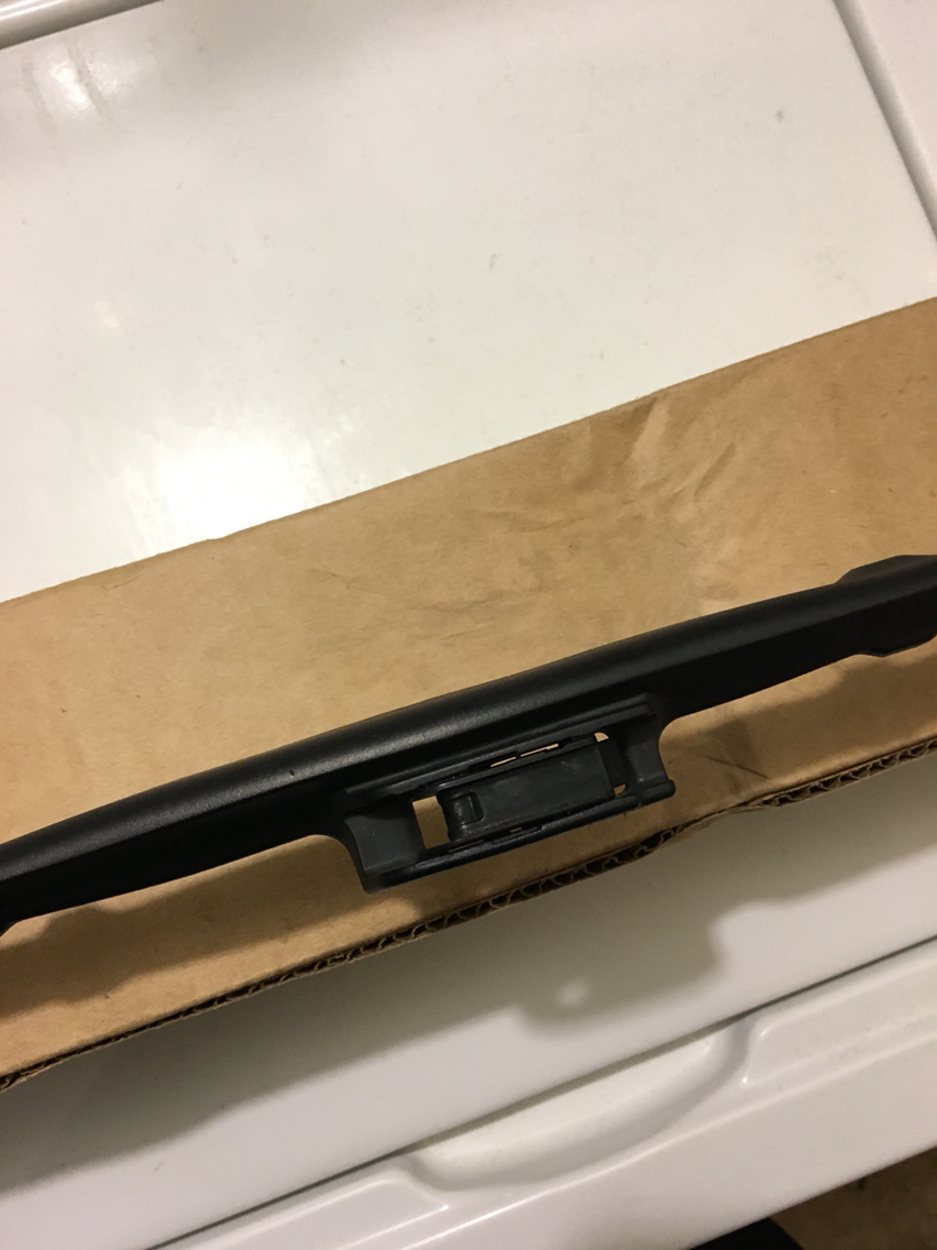

I purchased a set of OEM wiper blade refills. However, I had troubles getting the old blades off the housing. I think the wiper blade housing isn't OEM. I removed the housing off my car and took some pictures of it, hoping anybody can shed some light.

looks like it is.
FYI, the TRICO Flex beam-style wipers have the same side-loading mount as the factory ones, so they stay low on the window.

Should have just bought Bosch Icon's or Trico Onyx IMO. It's a j hook, so it should be pretty simple. The 3rd picture you posted is where the j hook slides in. To remove it there should be a little tab underneath that push/pull while at the same time pulling the wiper the correct way for the hook to slide out...if that makes sense.
