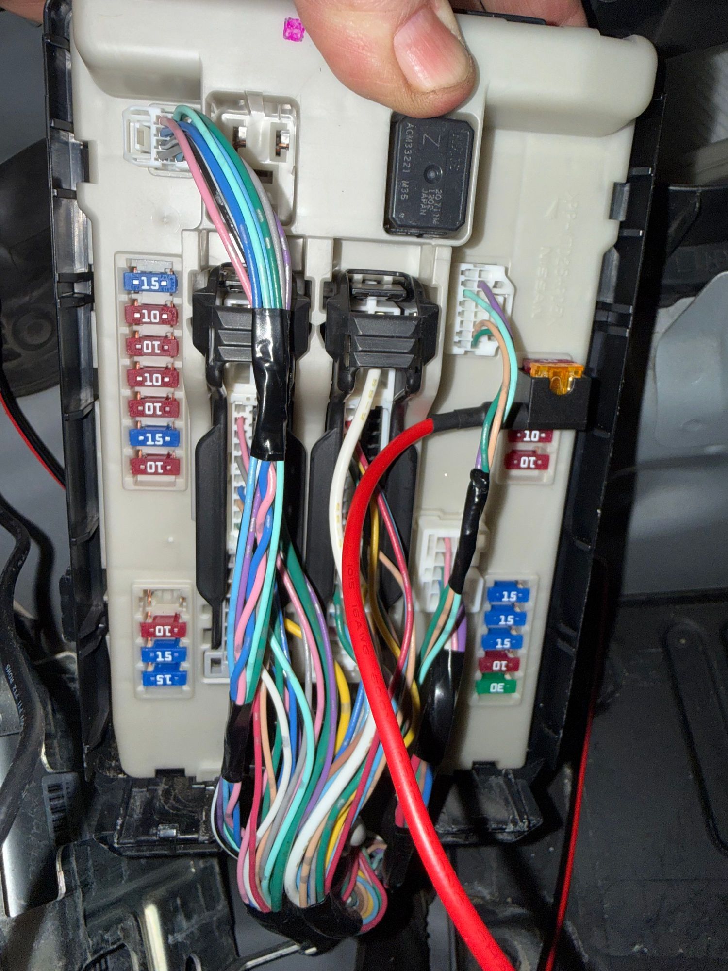

IPDM fuse box next to the battery. Not easy to remove as the two clips allowed some movement, but not enough to remove. I was almost ready to give up tugging on it, but then the box slide right out. Connect the orange wire from the power harness to to taillight fuse as it controls dimming of the gauge lighting. Works perfectly to dim the gauge lighting 30% when the lights come on.
