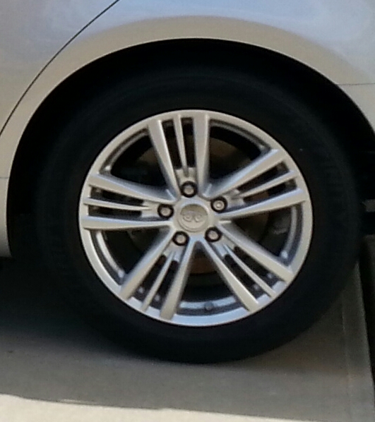

I'm a long way off on needing tires, when I bought mine, they had a brand new set of Definity tires on there. I've already started looking at a replacement set as I know one day, I'll need to. I am glad to hear that I can go to 245 on the stock rims...without any stretching.
I had basically decided on one of 2 tires in the 225 size....Continental DWS or HanKook Ventus 1 Noble 2. Both have excellent rankings on tirerack, and relatively high treadwear life numbers on the UTQG...and both are Ultra High Performance All-Season. I can't get the Hankook in 245/50-17 unfortunately, and the 245/50-17 Continental are overpriced IMHO. I'll probably go with the stock size on my next set unless things change.
To confirm, this is the stock rim to which you refer that accepts up to 255 width?:

Since you live in NC, you might want to consider using your 17s (and yes, those are the wheels that I was referring to) for a winter set, then find a set of 18s or 19s w/ dedicated summer tires for a more performance oriented drive. These Sport Edition 18s would be a good fit, new on tirerack they're about $150 each, and you could run 245/45/18 summer tires
