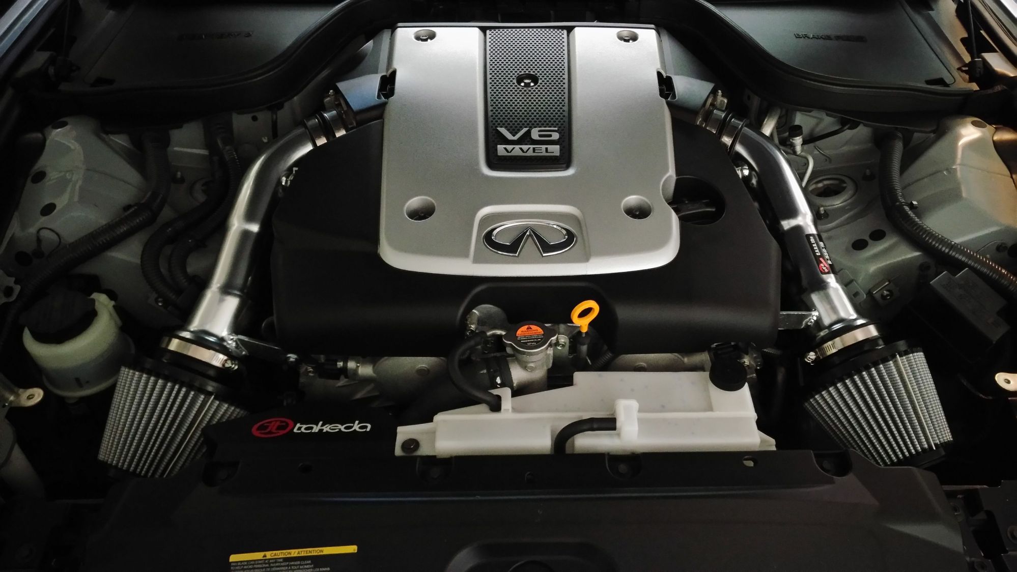

I am new to this site and have recently purchased a 2012 G37XS coupe and love it. Now that I have been driving it for a few months I have noticed the acceleration(pedal) lag and am looking for more power. I've been reading tons of threads on potential mods and I have a few questions. Takeda short ram intakes state they provide an additional 18HP plus 20 pounds/ft of torque and quicker throttle response just by replacing your stock COI. Anyone buy/install these and have you seen the stated improvements?

I just had these installed today... I'll let you know how it goes. Just from my readings on the Torque Pro app, my MAF shows a lot more air, but the Intake temperature is also higher; but this is what I expected.
I seriously doubt that I'm going to get 18HP and 20 ft/lbs torque, but I can tell you that I really like the additional engine growl at about 3000 RPM!
My mechanics said that there were some fitment issues on the driver's side intake, where they had to bend the chassis mounting arm a bit and the tube's angle isn't perfect. Anyways, take note of that if you decide on this kit.

Technically this short ram intake isn't a cold air because they suck air in from the hot engine bay. I had this setup and it did sound a lot nicer and perhaps the pickup was a little better but it doesn't improve the throttle response. For that you would need a tune.
If you want to go cold air then look at their cold air version or the Stillen Gen 3. The benefit of the Takeda is you won't have to modify the car in any way to install.
