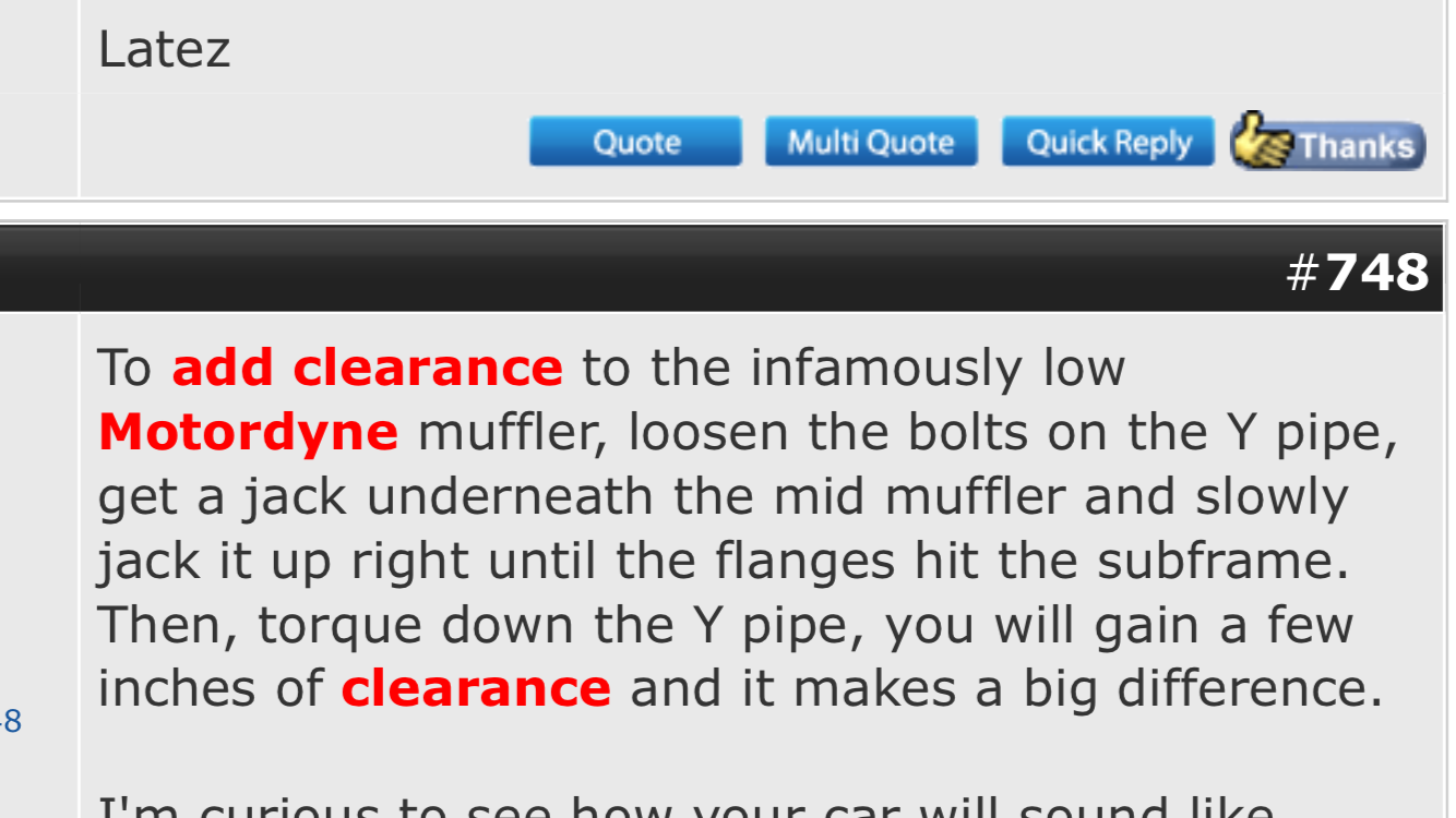

Received 67 Likes on 58 Posts
I bought the coupe motordyne exhaust and mine rubs easily and I’m not even dropped that low. Anyone have the same issue. If I go in a parking garage and use the ramp to the next level the box after the Y pipe always scrapes. My buddies scrapes too and I’ve had to weld his box back up 3 times.
Is there a way to modify the exhaust to sit higher up in the car? Shorter rubber hangars?

Originally Posted by Calg37USMC
That was me that mentioned that. However, after I did that, I could never get the Y pipe to ART pipe flange connection to line up. I measured the flanges and they were 100% straight. That connection always leaked with like literally 5 different type of gaskets (OEM, aftermarket, etc).
It just seems like a really common leak point on these cars. It drove me crazy.

Received 3 Likes on 3 Posts
I did this but now the flanges leak condensation like crazy! Is that bad?? Cuz I am really bummed about losing some clearance and lowering it back down just because of the leaks at the flanges.
