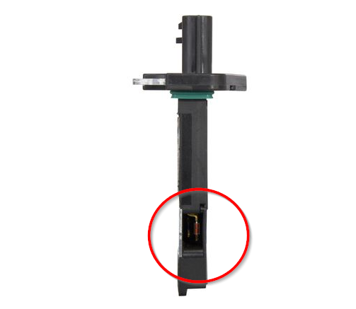

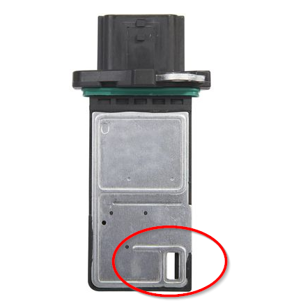

Here are a couple of pics that should help with cleaning, once you pull the MAFs out. It is only two screws per MAF and they are very low torque screws. Unplug each side and then pull one out, clean it, let it sit to the side and dry off, while you pull the other side clean it, and then let it sit while you reinstall the first side.
