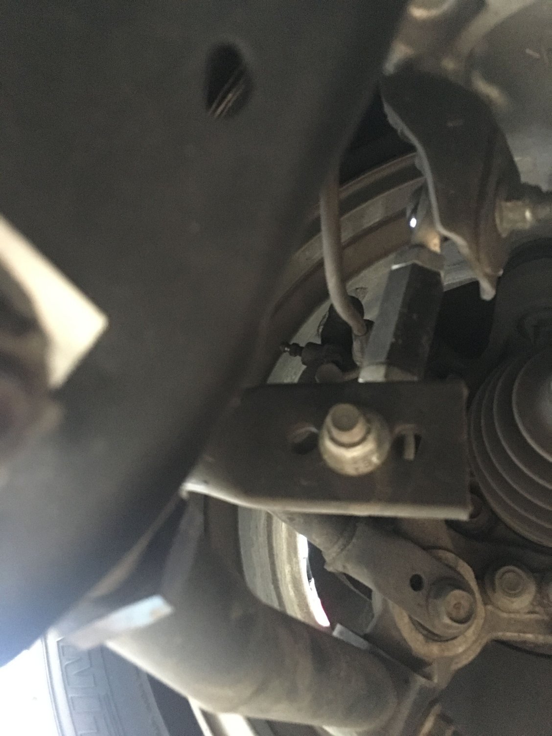

Front sway bar setting.
Rear sway bar setting.
Delete windshield washer reservoir
Z1 slotted brakes
Hawk pads
Front diff is leaking!
Front diff leak
Brake master cylinder brace. Got all 3 screws in.
Headers
Headers
Headers
Headers
Headers
Headers
Z1 motor mount. Helped solve clearance issue with my headers by lifting motor up a little bit. Sooooo happy
Trans cooler lines. The other end, not the coolers side but what they hook into on the car.
