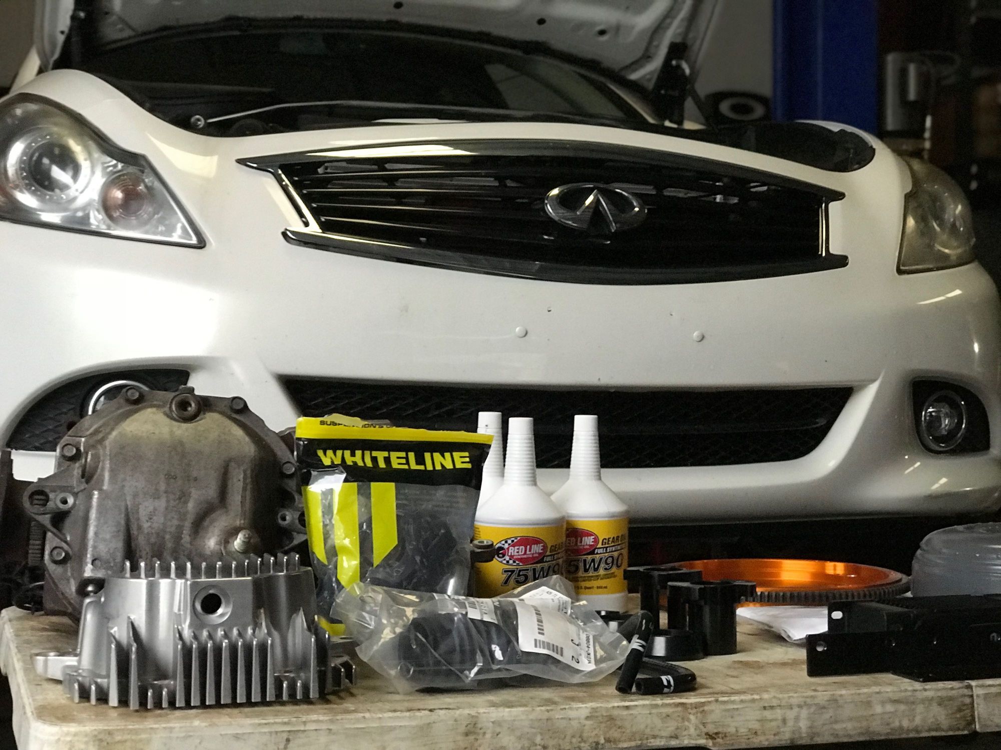

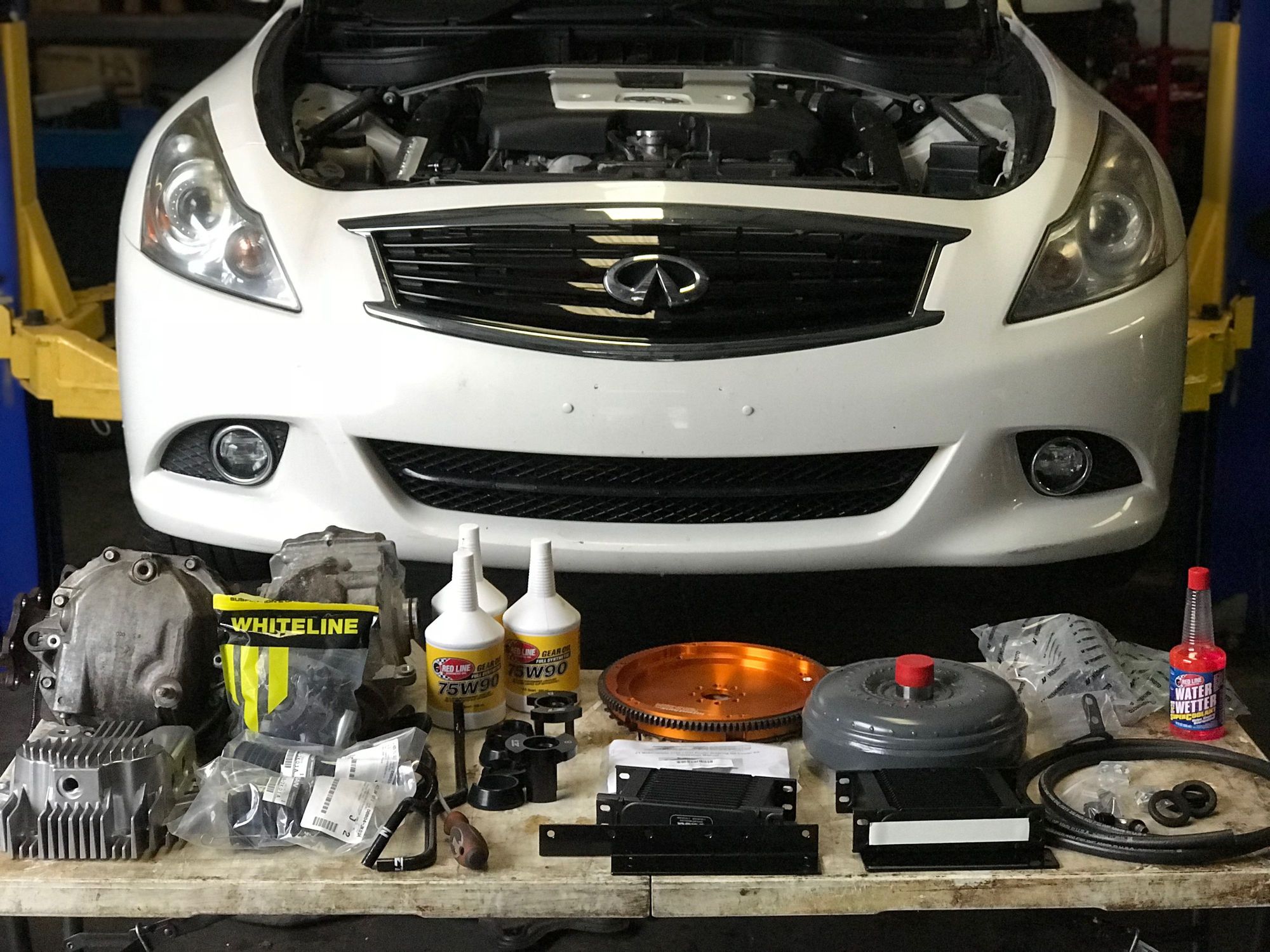

Old 06-28-2018, 01:39 PM
  #177
lorentzoe45
lorentzoe45's Avatar
Join Date: Jun 2015
Location: Gwinnett County, Georgia
Posts: 673
Thanked 72 Times in 63 Posts

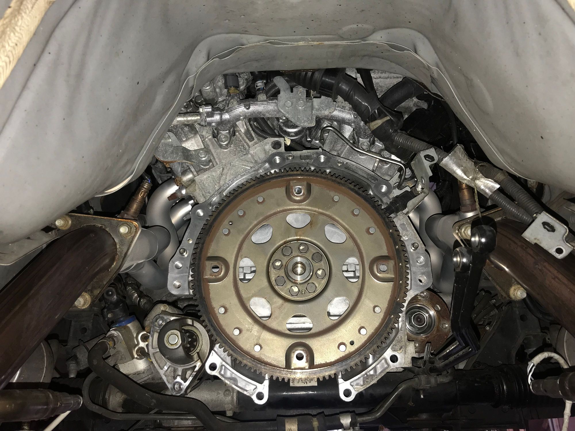

Oem flex plate. Going to replace with orange flex plate pictured below. Camera is where transmission sits

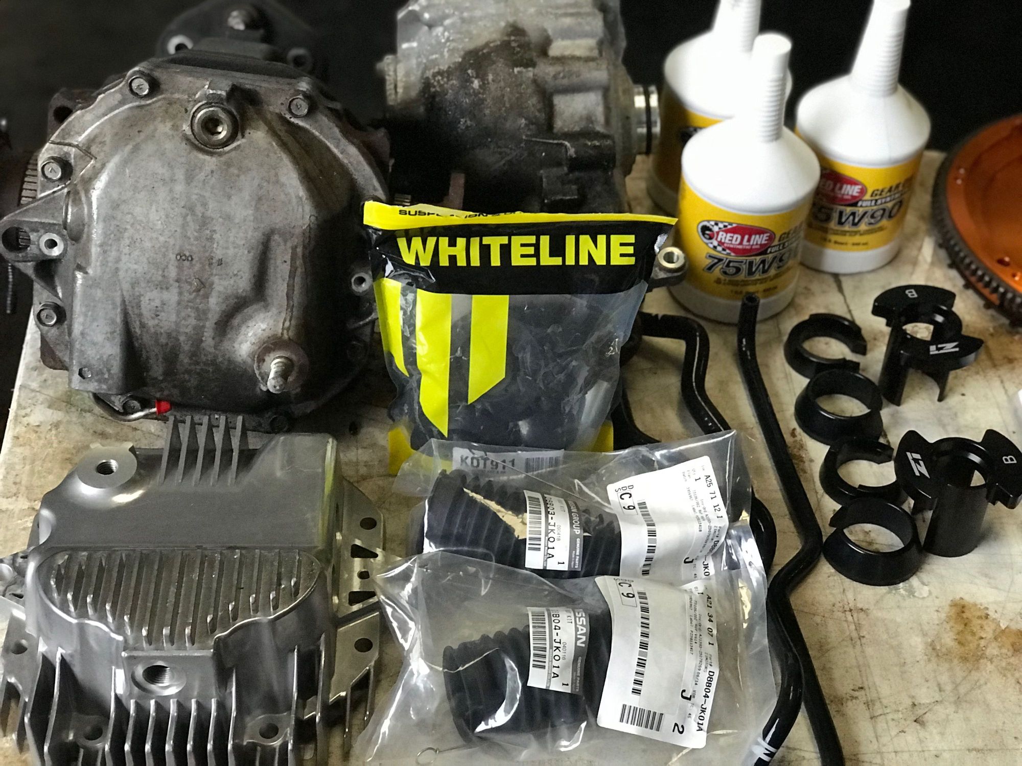

Top left is a g35 lsd diff, underneath is z1 rear diff cover
Second from the top on left is front diff from g35x.
Whiteline bushings and underneath that is new boots for the rack.
Sub frame collar bottom right of pic
Flex plate (orange in picture)
Stall converter (silver circle with red cap)
Power steering and trans cooler (black squares)

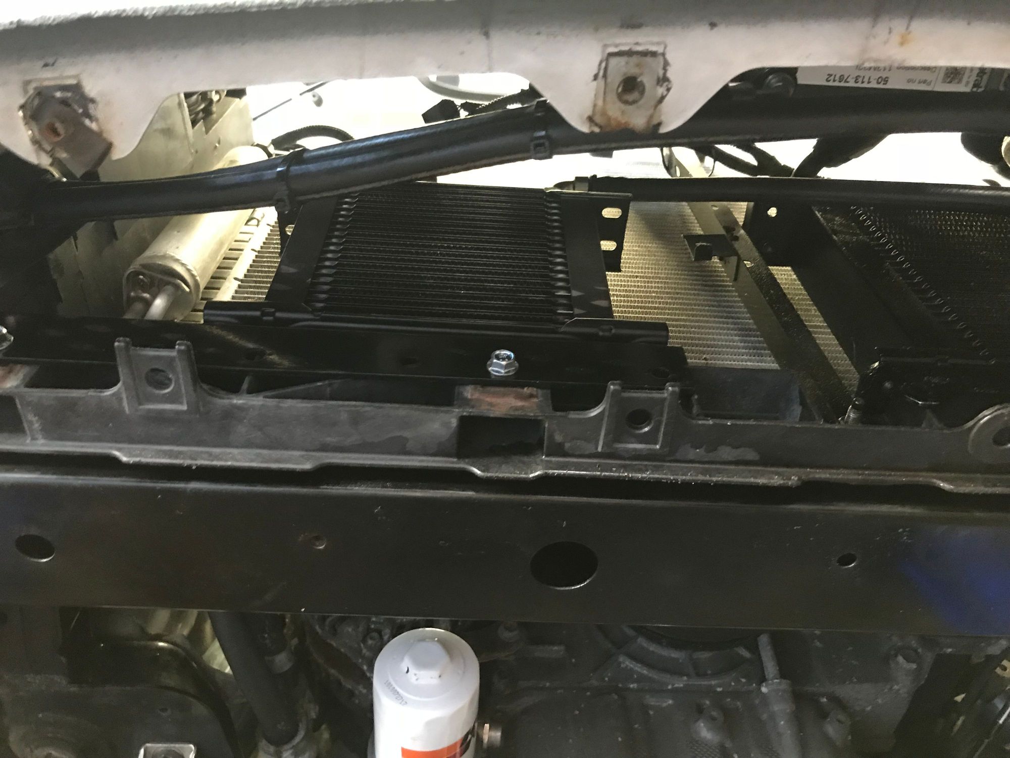

Old 06-30-2018, 01:05 PM
  #179
lorentzoe45
Join Date: Jun 2015
Posts: 673
Everything in just waiting on driveshaft!!

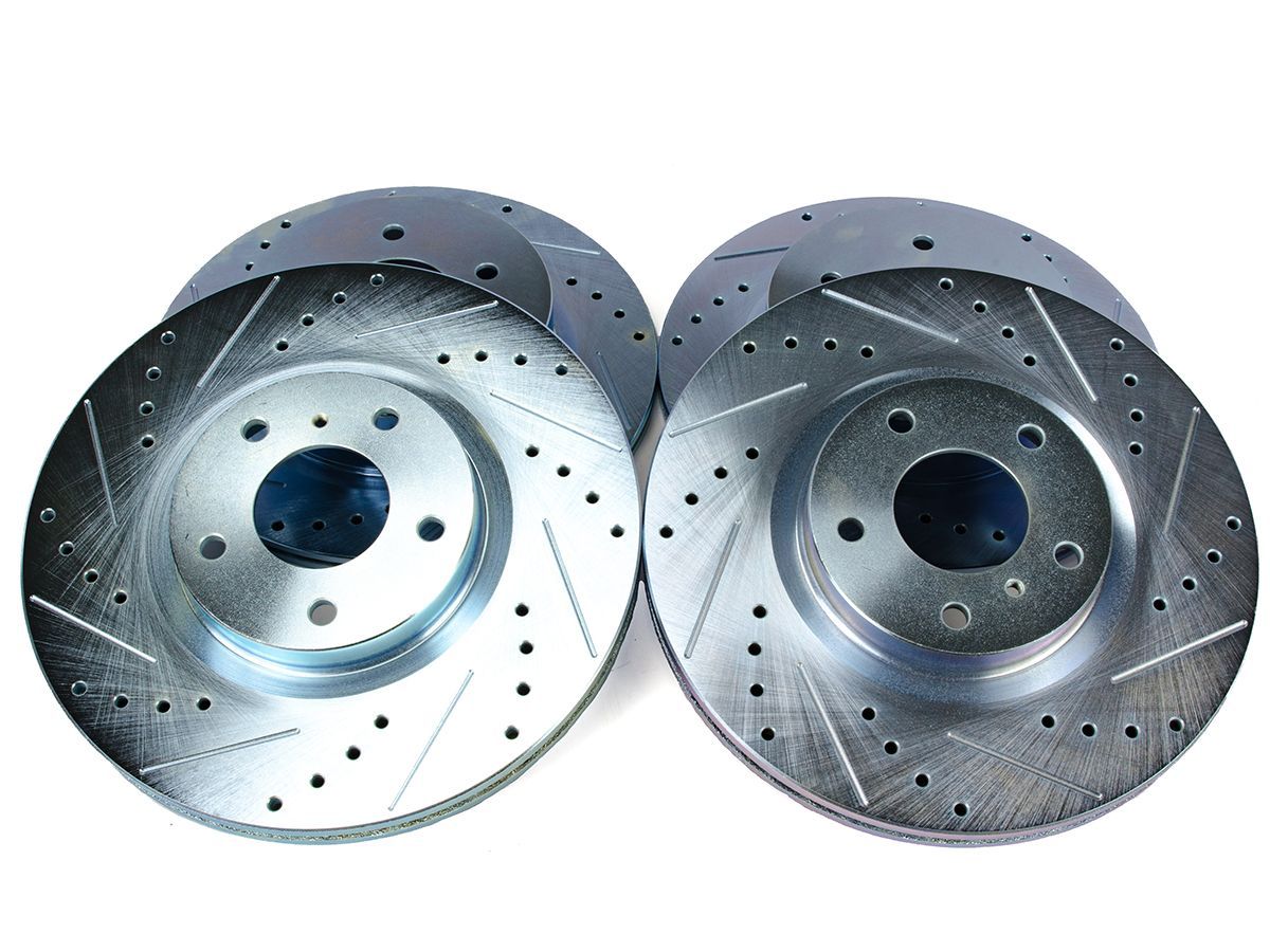

Warped my centric blanks I had on. Swapping to these. Slotted only though. I’ll be upgrading to a bbk in some time. For now this works since I have hard time finding something to clear my 17 inch rpf1
Swapping back to these from the posi quiet. Parking brake is posi quiet

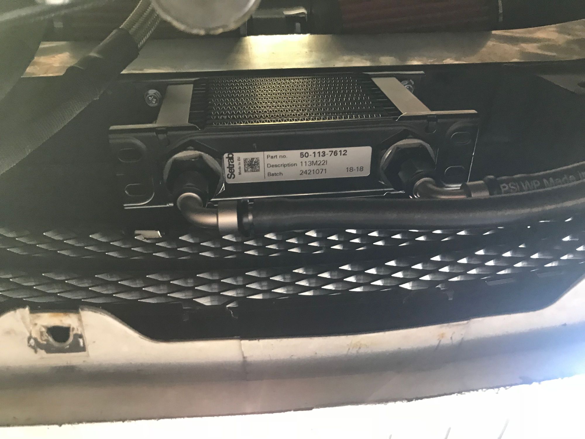

3 coolers pictured. Left side is the trans cooler. Exactly next to it to the right is the oil cooler. In front of oil cooler and the trans cooler (mounted at same height as other coolers just moved 10 inches forward or so) is the power steering cooler.
Power steering cooler.
So the diff swap and trans install went fine. We wanted to wait till after we swapped diffs just to make sure we had the right size. Driveshaft shop has a 6 WEEK wait on custom driveshafts. Ended up having to do a custom local one piece aluminum driveshaft. Also going to cost me $1000 for just the aluminum. Not happy about it at all, really really wanted one from thedriveshaftshop but can’t wait 6 weeks. The oem one won’t fit? The local shop is going to have it custom made and ready on Tuesday for install and balanced to 9k rpm. After this driveshaft is installed, this part of the build will be complete. Then we do the break in period on trans. Going real easy on it for a month. Needs a bunch of heat cycles. I have to change the fluid every 1000 miles for 3k miles. So 3 times I will have to drain and fill. Not entirely sure why 1k miles then change but I’m guessing they look at oil make sure no shavings. Also I was told my last trans the fluid was burnt up. I’m sure they test the oil make sure stuff is good? All guesses here.

Old 06-30-2018, 01:16 PM
  #180
lorentzoe45
Join Date: Jun 2015
Posts: 673
Originally Posted by G37XS13 View Post
Hey Lorentzoe, great build. Can you please let me know how you routed your Z1 Oil Cooler?
Hey buddy, I’ll get a few detailed pictures for ya on Monday and upload it. They are actually rerouting the lines and swapping some of the fittings around that have the different degree angles to make it go where they want it to. Changing it up from the way I’ve had it for 2 years. I’ll be sure to post up the new setup. They said it could be routed better than I did it. Which isn’t hard to believe because I just put it in however it would fit. But I can say that I’m extremely excited to have the lines rerouted and setup updated. Currently right next to the front sway bar is the oil filter. Well that Thermostat plate has a weird angle on it and if I bottom out hard it will brake the fitting off to the oil lines and spew out oil everywhere. This actually has happened before (mentioned somewhere in this thread)
Fingers crossed.
