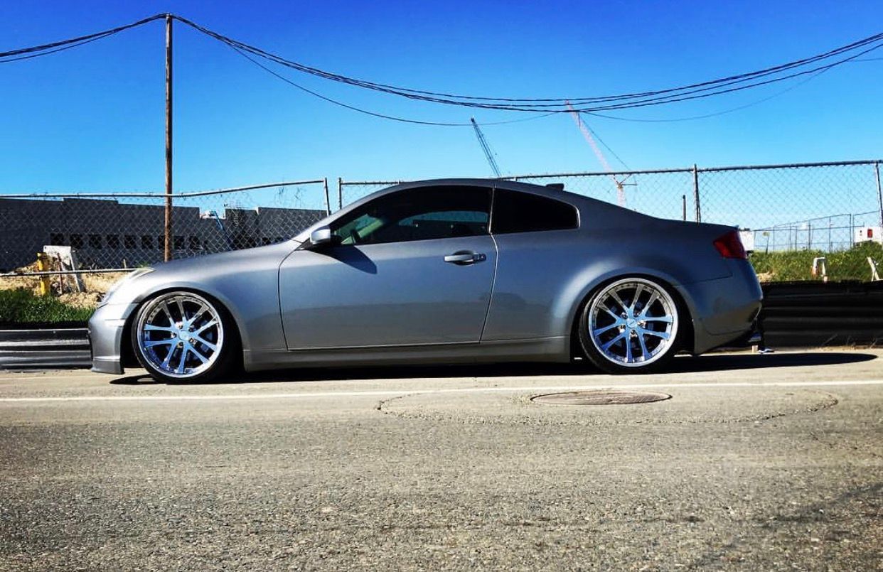

Hello all. I finally got my first G37S. I am looking to do the basic mods to it....intake, coilovers, wheels. Nothing too aggressive. But I have a few questions and figured I would start here. I want to lower my coupe about 3". I also want my wheels to be flushed with a slight camber. I often notice that those who have some type of camber to their wheels have more of a rounded tire. Why is that? Are they bought like that or do they wear like that because of the camber positioning? With that being said, what tires would you all recommend (size and brand) and what wheel size? I'm leaning towards 18s or 19s. I want it to look like this...thanks for all your help!
I dont want to be that low low like the one on the bottom. I just like how the wheels are flushed. What would I have to do to get my wheels flushed like that without rubbing?
You can get a pretty tight fit at the fender with proper homework regarding offsets, wheel & tire widths. Like I said, take a look at the cars in that build thread, there's some tight setups! One coupe that really stands out as far as fit at the fender and and overall aggressive stance, but one that you can safely drive is Vizards' coupe here~

The "rounded" tire thing is people stretching their tires (or at least that's what I think you're describing). This happens when you buy a tire that is slightly skinnier than the suggested tire width for a wheel. So if that's the look you like, find the width wheel you want, find the suggested tire size, then go down a few mm from that size. Boom stretched tires.

If you want to go that low I'd go 19". A lot of people here have 20" but I like the look of BBK filling up the wheels and since you have a sport I'd recommend 19". I have a sport on stock wheels and I run Michelin Pilot Sports 245/40 front and 275/35 rear. The size of the tire is going to depend on the size of the wheel.
