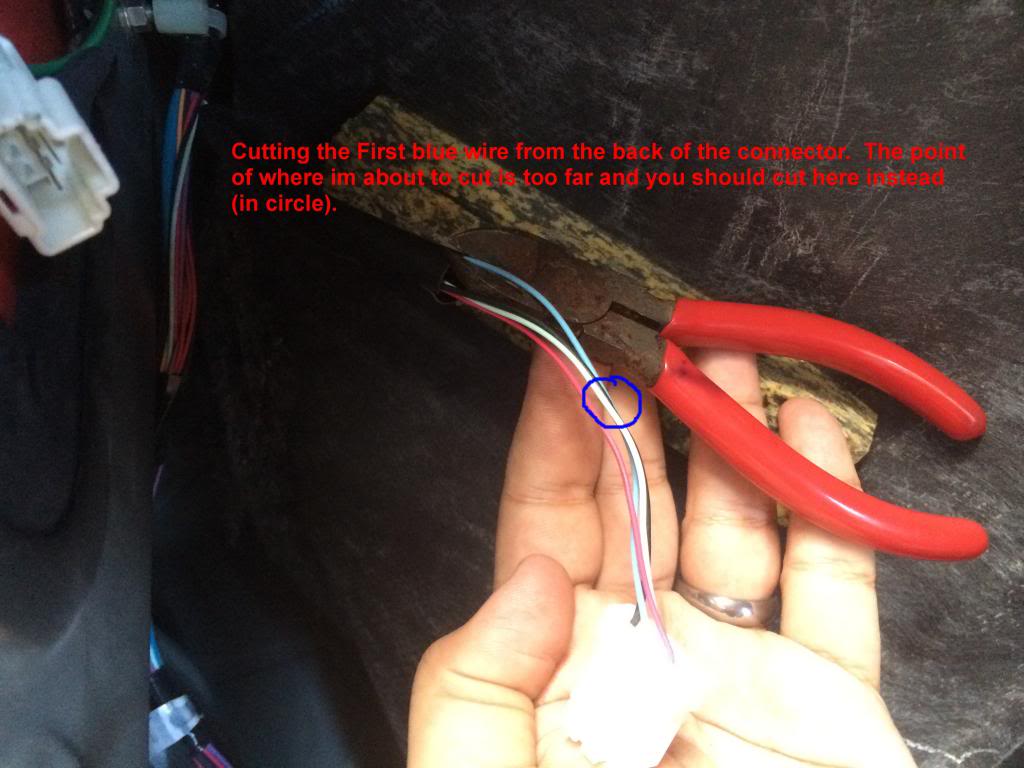

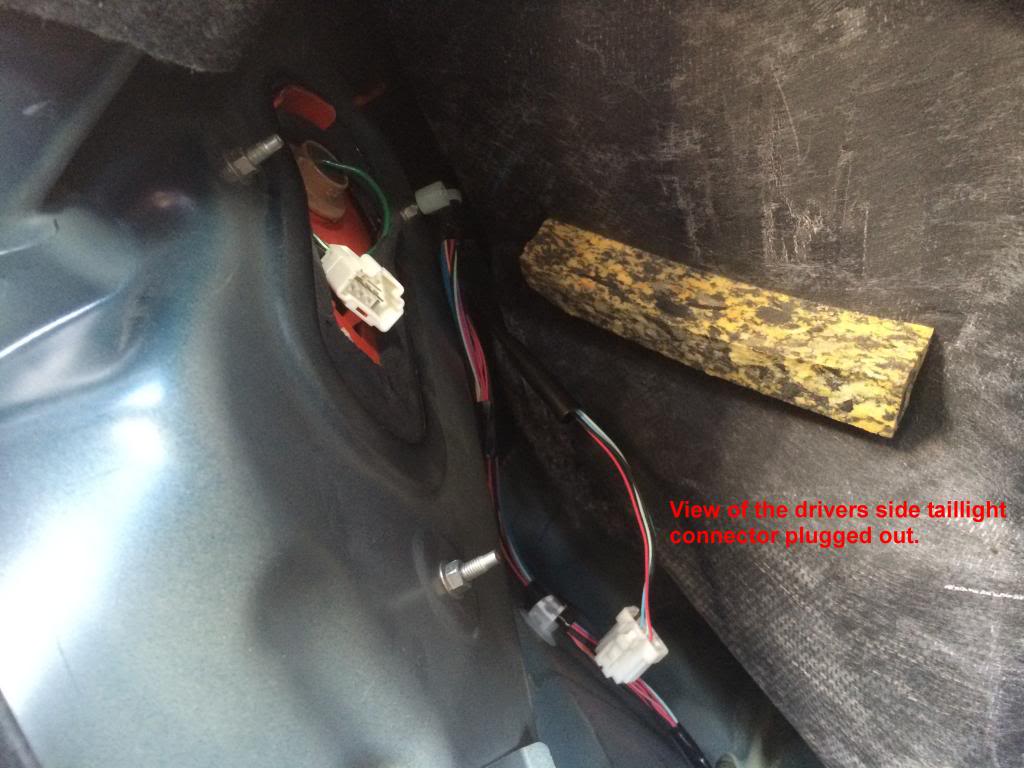

Step 4: On the Drivers Side Tailight, Disconnect the Tab from the back. You will now see about 4-6 wires that are color coded. You then test and cut the wires according to the instructions.

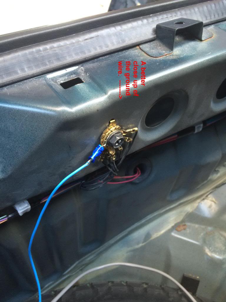

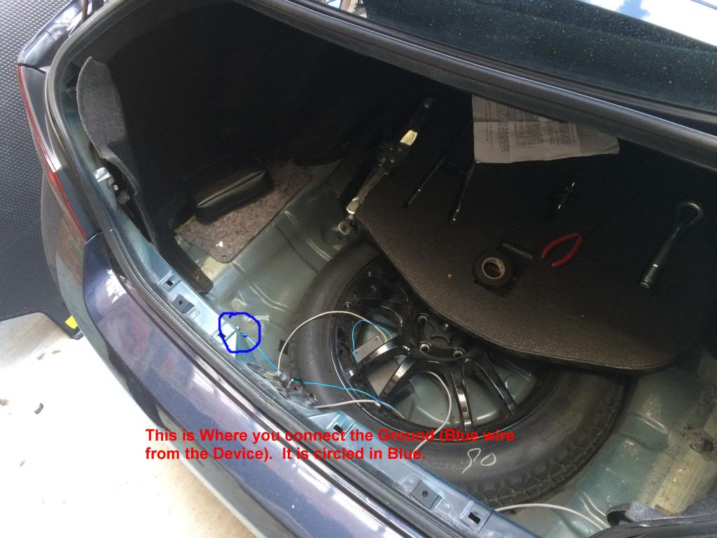

Step 5: First Ground the unit (blue wire) to the factory ground location near trunk latch. Pic Reference. Then place the device you purchased under the tool tray closer to the drivers side or somewhere close to the drivers side taillight without the wires getting in the way when you put back the rear mat.

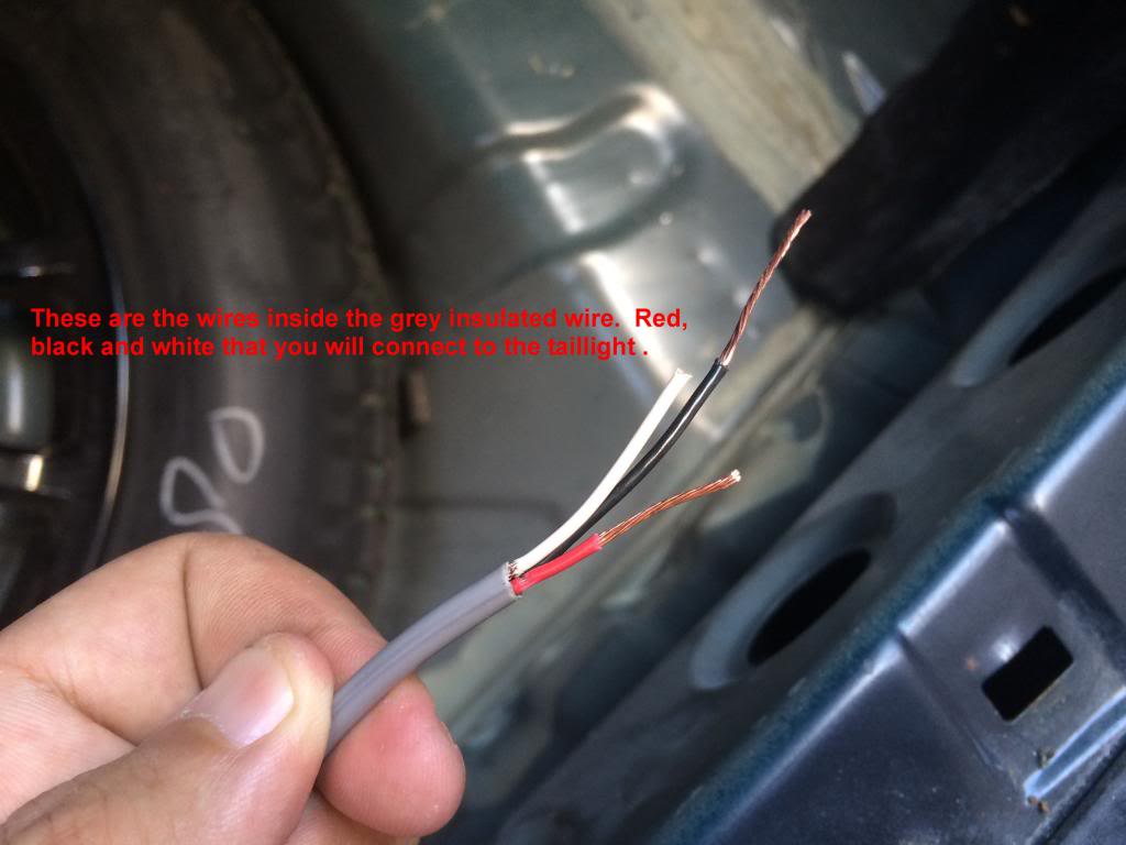

Step 6: Strip the wiring from the 2 large Grey wires and reveal the Black, red and White wires and strip them to be ready to connect to the taillight wires.

Step 7: Now go to drivers side tail light and we start with the Blue wire, Cut it about 2 -3 inches from the connector. Tape up the side sticking from the connector with electrical tape. For the other side, connect the black wire to it. You can use the included connectors or just simply twist both wires onto each other.

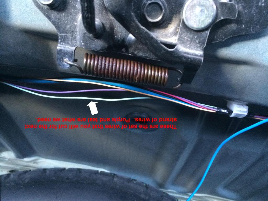

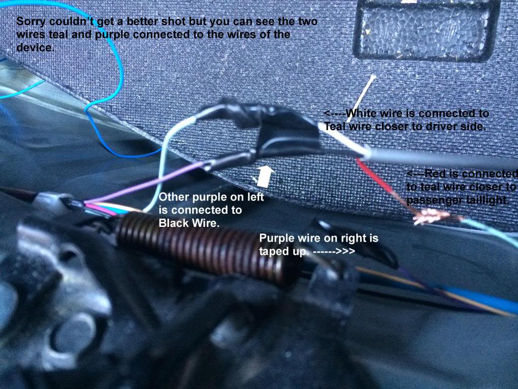

Step 9: Next step is to access the wires right under the trunk latch lock. They run across the bottom of the trunk. Here you will only need to cut the purple and Teal. First Cut the Teal Wire somewhere near the latch (as long as the device wires can reach it). Then Connect Red wire from the device to the teal side (the one going to the passenger taillight). For the other end of the teal wire, you connect the white wire.

Step 10: now cut the purple wire and tape of the side that is going to the passenger side light. For the other side of the purple wire, connect it to the black wire from the Device).

What are you going to do if you need to use your spare tire?

I just did this the other day, meant to take pictures too but I forgot. I actually soldered my connections though. I also hope you ran your wires under the spare, and not through the spare like your first picture otherwise you won't be able to take it out lol.

That location was at the beginning at first as I thought I would have to run wires to both taillights. After setting the ground, I realized it didn't need to be there. It is now tucked under the tray close to the ground wire. So I can easily take out the spare without getting in the way of wires.
