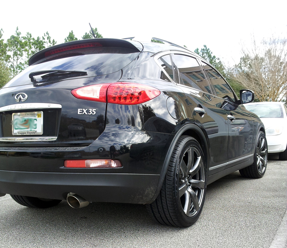

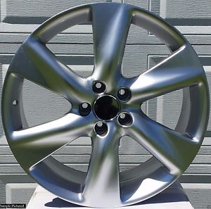

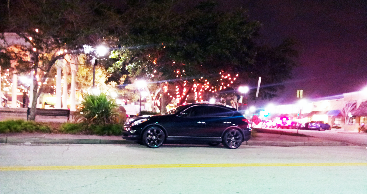

As many of you know, I do not have a G. I have an EX35. I've looked around and tried to find a 19" and/or 20" wheel that I like for my car. My initial plan was to lower the car, however this past winter season has shown me that that is not practical. My car is a pretty decent height, so that is not too bad. I'll just opt for coilovers to obtain stiffness and adjustability. After looking at various wheels, pictures, etc. I've decided that the 21" FX50s wheel is PERFECT.
Specs are 21x9.5 +50
I need help with tire sizes
My initial choice was a GTR front wheel squared setup (20x9.5 +45) with 285/35/20 or 275/40/20 tires. I saw this setup on a member's EX (OhThatGuy) and realized that wheel gap is just too much for my liking.
Using that setup as a reference, what tire size/option would work for me? Remember, I'm going for a 21" wheel, not a 20". Also, I'm thinking 5mm spacers all around would get me that perfect flush look.
(the last photo is the 21" FX wheel)
Thanks in advance

What are the OEM wheel specs for your EX? Only real concern would be the high pricetag on 21" tires, I'm guessing they'd be 30% more than 20s.

21" wheels sound like they're going to be too big on the EX. Especially since you're not going to be lowered, they might look like monster truck wheels on stock height. Those 20" GTR wheels look perfect in that picture though, that's what I'd go with.
Also I agree with blnewt, 21" is an odd size and tires will be hard to find/expensive.

So I just searched and can't find anyone selling the 21" FX wheels. Found some on eBay, but they are black and not cheap. Don't feel like spending all of that money on OEM wheels just to have them powdercoated. All the used ones I've found look like crap. I'll search for 20", but if I come across 21's, I may pull the trigger.

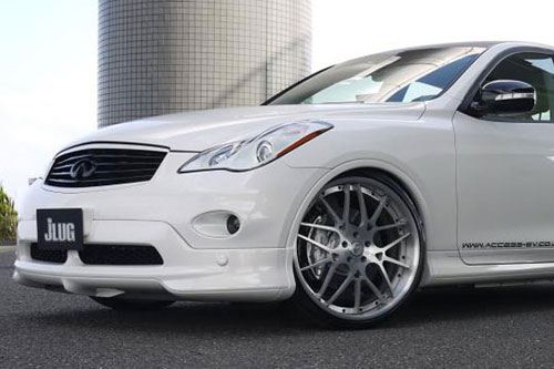

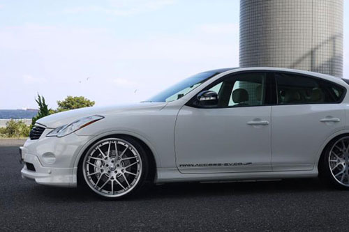

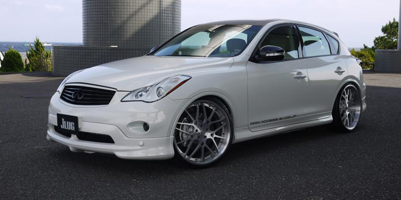

I've seen an EX35 on 22" Forgiato wheels (online). Gorgeous, but it was definitely lowered. The ride height doesn't look like it would be difficult to manage though. Since I left the city, the roads are way better
