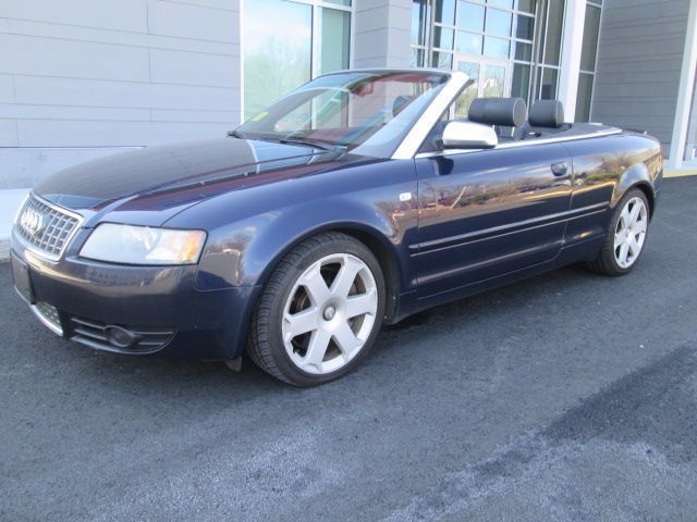

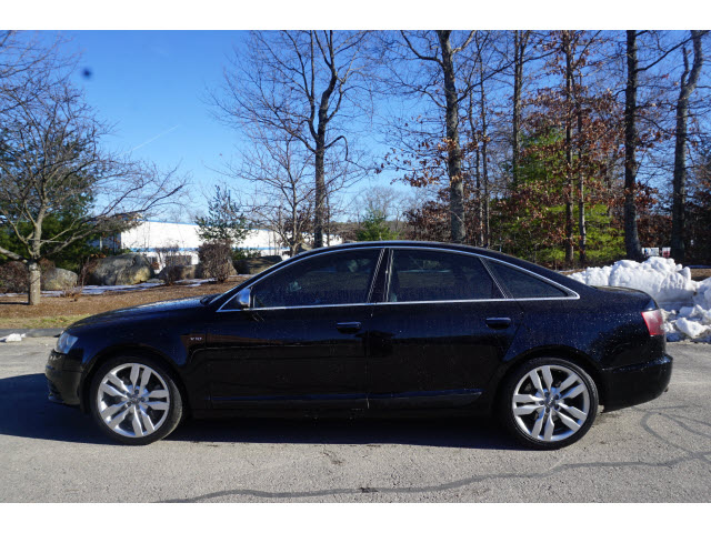

Received 394 Likes on 343 Posts
no :/ They made the S4 as a vert( Coupe) my best friend had one. Now he has a S6 V10!
Attached Thumbnails Yea I'm out-2004_audi_s4-pic-8688013493938673732-1024x768.jpeg   Yea I'm out-2008_audi_s6-pic-3011282981247555660-1024x768.jpeg
My fault. For some reason i was thinking about only the newer models 2010+
