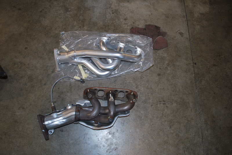

Completely different. I have had a Maxima and a 350Z/G35/G37, and the engine is mounted transversely on the Maxima, and there is 3x the amount of room to get to the headers. I promise it will take you at least 5-6 hours. Go on G35driver or My350Z and ask anyone that has installed headers what they think, and I think you will agree. Really, that is not that big of a deal, but not worth it unless you have done all other possible breathing and tuning mods. Then if you think 6+ hours to install, and 5-10HP is worth $700+, go for it. Headers and Y-pipes seemed to be good mods on the Maxima, but neither does a whole lot on the VQ'ed Z/G. I am pretty sure this is one reason the Maxima puts out a lot less power to start with.... There is more room to improve.
I will add, I am not saying headers are a bad mod. It is just not where I would start, and I would consider waiting for some others to come out. As far as I know Stillen is the only one to offer headers right now. They "claim" 14HP/12TQ, and I think most will agree that Stillen's claims are very generous (most of their products gain half of what they claim at best--they claim 23HP on their 04 G35 sedan exhaust and I got 7HP on mine).
They claim 18HP on their Gen 3 intake for the G37, most people are getting in the 5-10HP range. They claim almost 20HP for their exhaust, and all are getting much less. I think it is safe to say you will get less than the 14HP they claim with their headers. Maybe some others will come out, but I have not seen a G/Z gain more than 10HP by themselves (maybe Crawford headers on the 350Z gained 10+HP, but that is it).
I am all for someone to prove me wrong, and really the cost of the Stillen headers is not bad. I would like to see someone try them out. I would even be willing to contribute some $$ for some before/after dynos. Unfortunately, past testing has shown that our exhaust manifolds breath pretty well compared to other cars.
EDIT: So, I did some searching after I posted this, and I found a good post on another website. I would check it out. It looks like he lost a crap load in the midrange (TQ), and there were negligible HP gains up top (5HP). As usual, Stillen hopped on and said that the gains were not normal, but the dyno's say enough for me about Stillen's headers. Take a look at this: http://www.the370z.com/intake-exhaus...html#post51721. I also found a few post that covered the install, and all said it was a PITA, and a 6+ HR install (and fitment was not great)....
I have attached a picture comparing our factory manifolds/headers to the Stillen (I got this pic from the above link). Not much difference, and I am guessing the Maxima headers look nothing like the stockers on the G37 (my Maxima manifolds looked a lot different).

Word up! Agreed! Honestly, I would never install headers on a car unless the stock manifold has a cat built on to it. That's usually what causes the most restriction. The HP gains are not worth it otherwise.
